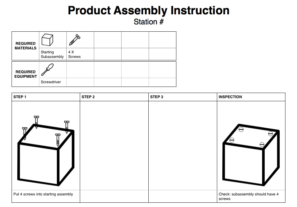

At 10-100 units, the toughest part can be outsourcing assembly. Therefore, most companies assemble in-house or get on-demand temporary contractors to help out. We recommend you keep the assembly process simple, create crystal clear work instructions, and avoid specialized assembly processes, such as ultrasonic welding.
![Example of clear work instructions](https://www.fictiv.com/wp-content/uploads/2020/09/best-practices-for-manufacturing-at-different-volumes2.png)
Check out our article on Secrets from a Factory Assembly Line for more tips and best practices here.

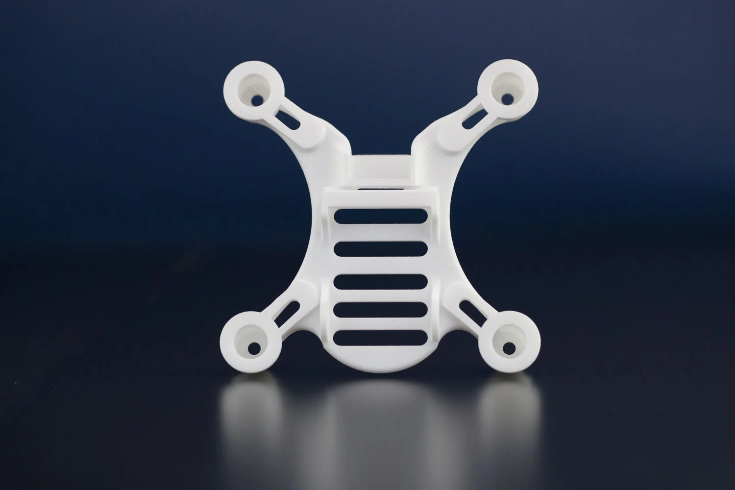

In the additive space, SLS 3D printing is a great choice for low-volume production, due to large build volumes and relative ease of cleaning. Beyond 100 units, SLS can still be a good option for producing small, complex internal components. One of the most interesting production applications of SLS Nylon that we’ve seen is designer eyewear:
![ic! Berlin Exoskeleton Sunglasses](https://www.fictiv.com/wp-content/uploads/2020/09/best-practices-for-manufacturing-at-different-volumes3.png)
Materials for SLS 3D Printing
The most common plastic for SLS 3D printing is Nylon 12, but glass or carbon fibers can be added for additional strength (contact us for a custom quote here). These specialized material combinations are best suited for production volumes, due to material waste per batch of prints.

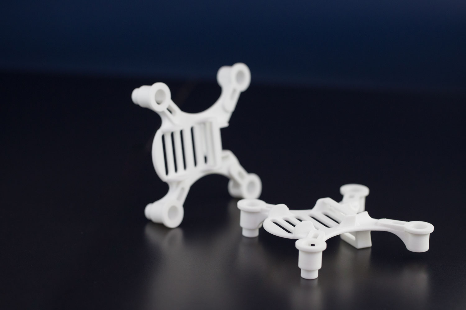

![Drone skeleton prototype made using SLS 3D printed Nylon material](https://www.fictiv.com/wp-content/uploads/2020/09/best-practices-for-manufacturing-at-different-volumes7.jpg)

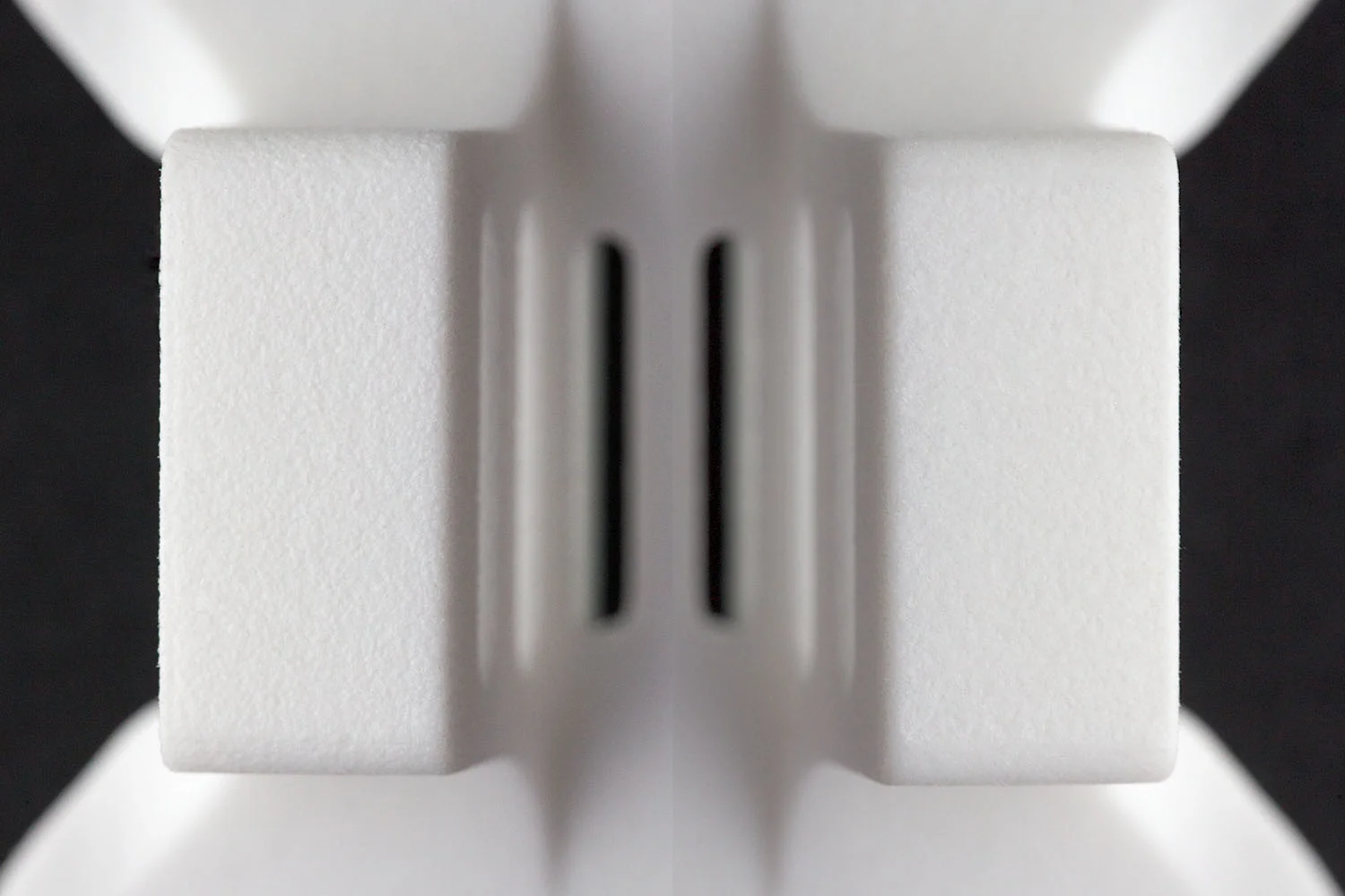

SLS Nylon is naturally white or off-white and can be painted and dyed easily. While the as-printed finish is an eggshell texture, parts can also be tumble polished to a smooth finish upon request.
![left: as-printed SLS Nylon, right: tumbled polished SLS Nylon](https://www.fictiv.com/wp-content/uploads/2020/09/SLS-compaired-reg-to-tumble.jpg)

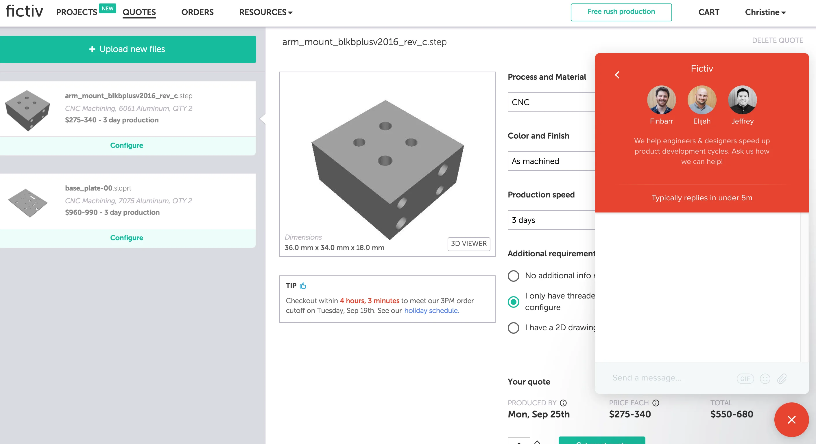

While it’s an expensive process for one-offs due to high setup costs, CNC machining is economical for small batch volumes. The unit cost usually starts leveling off above 50 units per batch, unless the initial tooling and setup costs are very high. The optimal batch volume is easy to determine — in your final quote request (Fictiv estimates are instant), you can always ask us for this information and we can break down your costs into setup and per-part cost. To get instant estimates + free DFM feedback for CNC machining, create your account here.

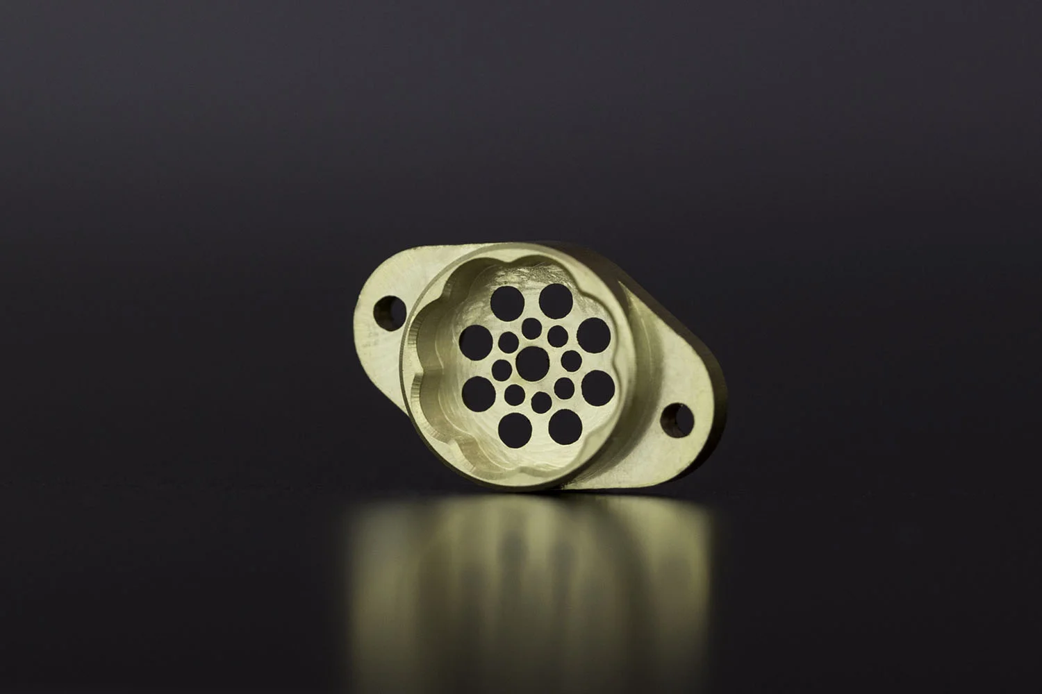

![CNC machined brass](https://www.fictiv.com/wp-content/uploads/2020/09/best-practices-for-manufacturing-at-different-volumes4.jpg)

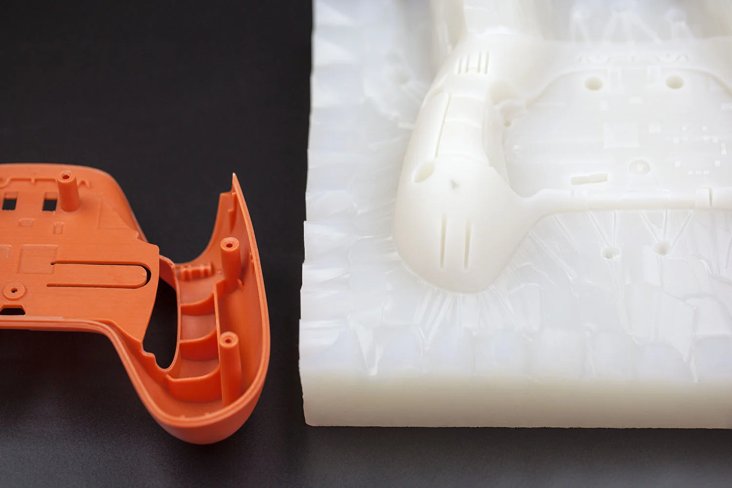

Urethane Casting for Manufacturing 10 – 100 Units
Urethane cast parts made from a silicone mold can often rival or exceed injection molding in quality, while being much more forgiving with geometry.
![](https://www.fictiv.com/wp-content/uploads/2020/09/RTV-page_4581.jpg)

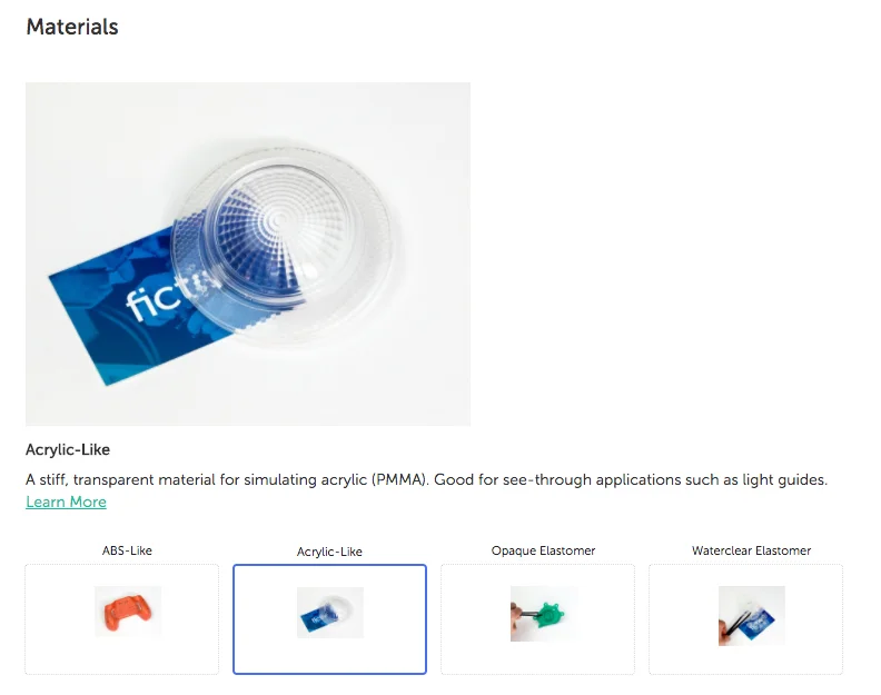

Material Options for Urethane Casting
Fictiv offers four materials for urethane casting (2 rigid plastics and 2 elastomers):
- ABS-Like Rigid Plastic – A general-purpose opaque material that simulates ABS thermoplastic. Good for most hardware product enclosures.
- Acrylic-Like Rigid Plastic – A stiff, transparent material for simulating acrylic (PMMA). Good for see-through applications such as light guides.
- Opaque Elastomer – Simulates all kinds of rubber-like materials such as TPE, TPU, and silicone rubber. Great for wearables, gaskets, and overmolds. Available from Shore 20A to Shore 90A in 10A increments.
- Waterclear Elastomer – Simulates all kinds of rubber-like materials such as TPE, TPU, and silicone rubber. Great for wearables, gaskets, and overmolds. Available from Shore 20A to Shore 90A in 10A increments.
![Explore material options for Urethane Casting in the Fictiv Capabilities Guide](https://www.fictiv.com/wp-content/uploads/2020/09/urethane-casting-material-options-capabilities.png)
Design Considerations for Urethane Casting
If your parts are designed for injection molding, urethane casting is the perfect substitute at low volume. The most economic order quantities are in multiples of 20. For tips on how to design parts specifically for this process, check out Fictiv’s free Urethane Casting Design Guide.
