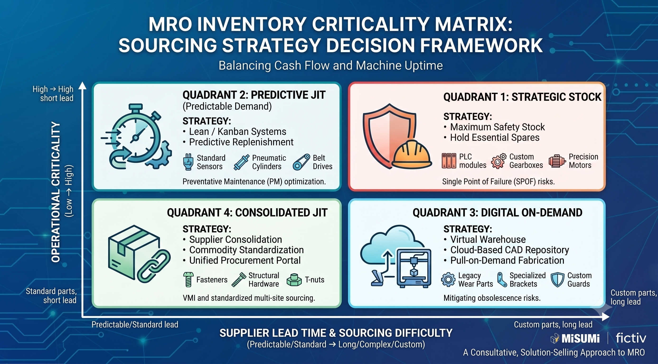

The MRO Criticality Matrix: Categorizing Your Spares
You can’t apply a blanket JIT or safety stock strategy to your entire Bill of Materials (BOM). To build an efficient ecosystem for MRO supply chain management, components must be classified into a quadrant system based on two primary operational variables: Lead Time/Sourcing Difficulty and Operational Criticality.
MRO inventory strategy matrix
Quadrant 1: High Criticality / Long Lead Time (Strategic Stock)
Component Examples: Main PLC modules, specialized servo motors, custom-machined index tables, proprietary gearboxes.
Strategy: Maximum Safety Stock. These are your single points of failure. Partner with a verified critical spare parts supplier to keep these units in stock on your local shelves, pre-configured and ready for immediate hot-swapping.
Quadrant 2: High Criticality / Short Lead Time (Predictive JIT)
Component Examples: Standard inductive proximity sensors, pneumatic cylinders, modular limit switches, V-belts.
Strategy: Predictive JIT / Kanban. Because these parts are readily available from an industrial spare parts supplier with overnight delivery, you can maintain minimal on-site stock. Use automated reorder points based on consumption rates.
Quadrant 3: Low Criticality / Long Lead Time (Digital On-Demand)
Component Examples: Legacy wear plates, custom structural brackets, specialized safety guards.
Strategy: Virtual Warehousing & Digital Inventory. Storing components for years on a shelf wastes valuable floor space and risks material degradation. The modern alternative is to optimize the procurement of spare MRO parts by preserving verified, production-ready CAD models within a digital manufacturing ecosystem. When an automated inspection or preventative maintenance cycle flags a wear threshold, the digital twin file is pulled and fabricated on demand—arriving precisely when the scheduled replacement window opens.
Quadrant 4: Low Criticality / Short Lead Time (Consolidated JIT)
Component Examples: Structural aluminum extrusions, T-nuts, generic fasteners, fluid power fittings.
Strategy: Pure JIT / Vendor-Managed Inventory (VMI). Consolidate these parts into a single supplier’s digital portal to automate replenishment and strip out administrative overhead.
