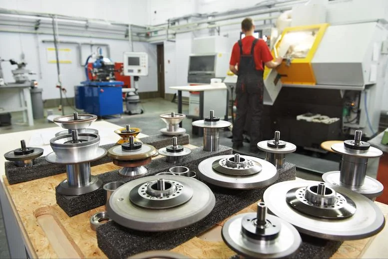

It’s usually not the most organized, clean, or well-lit area in a machine shop, but it is critical in supporting machining operations. In manufacturing facilities equipped with them, the toolroom is a designated space that engineers and expert machinists use to create and maintain tooling. This area is typically separate from the main production floor and serves as a storage, production, and maintenance hub for crucial tools like jigs, fixtures, and dies. When these tools are utilized in a production run and subsequently returned, the toolroom becomes the go-to place for inspecting and repairing them. While some machine shops outsource tool maintenance and/or manufacturing, an on-site toolroom enables optimized productivity and customizability in manufacturing processes.
The tooling manufactured and maintained in a toolroom isn’t your typical hammers and wrenches; we’re talking about sophisticated, high-value, precision assemblies integrated into production machinery. Think progressive stamping tools, die sets for metal shaping, various CNC tooling, and mold assemblies for plastic injection molding.
Inevitably, these tools endure the wear and tear of daily use and occasionally face unexpected damage. That’s where the toolroom comes to the rescue. Tool and die makers work magic to repair or create replacement parts for these essential tools in a toolroom. Among the lineup of machines you’ll find in a toolroom—lathes, saws, grinders—there’s one standout player: the toolroom mill. This versatile machine takes center stage, with the precision and power to restore damaged tools and fabricate new components.

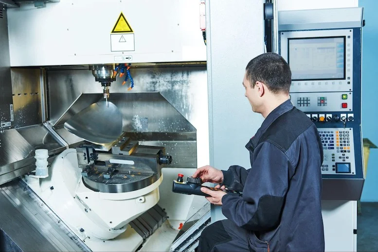

A CNC mill in action
When considering the purchase of a toolroom mill, it is crucial to consider the available space, the nature of the anticipated work, and the intended operators. Keeping these factors in mind, here are the key features to look for:
  1. High Precision and Accuracy: Toolroom mills are expected to deliver precise and accurate machining results. To expertly purchase a toolroom mill, look for machines with high-quality linear guideways, precision ball screws, and rigid construction to ensure consistent accuracy. Toolroom mills should be built with high-quality components and should be able to hold tight tolerances to ensure accurate and repeatable machining results.
  1. Compact Size: Toolroom mills are typically designed to be compact and space-saving, making them suitable for toolrooms and smaller workshop environments. The machine should have a small footprint while providing sufficient workspace for the intended machining tasks.
  1. Versatile Machining Options: Toolroom mills should offer versatile machining options for various applications, which helps to further strengthen the agility of a toolroom. Look for machines that can perform various machining operations such as milling, drilling, tapping, and even limited turning, if required. Also, look for a machine with flexibility in manual and CNC operation. The versatility of having a 3-axis CNC capability for intricate fixtures and molds and the convenience of a manual mill for tasks like tapped holes or quick slots significantly enhance a machinist’s productivity.
  1. User-Friendly Controls and Interface: The control interface of the toolroom mill should be intuitive and user-friendly. It should provide easy programming options, a clear display, and straightforward navigation for manual and CNC modes. A shallow learning curve ensures that novice and experienced machinists can quickly grasp and operate the CNC toolroom mill effectively.
  1. Tooling Options: Toolroom mills are compatible with various cutting tools, including end mills, drills, reamers, and special tooling for specific applications.
  1. Table Movement: Toolroom mills typically have a movable table that can be adjusted in multiple directions (X, Y, and Z axes), enabling the machining of complex geometries. A 4th-axis rotary table expands the possibilities for machining intricate components.
  1. 4th-Axis Capability: In addition to the standard X, Y, and Z-axis movements, the inclusion of a 4th-axis rotary table provides expanded machining options for intricate and complex parts.
  1. Coolant System: A built-in coolant system is crucial for maintaining optimal temperatures during machining, preventing tool failure, and efficiently removing chips from the workpiece.
  1. Taper Spindle: An R8 taper, commonly found on Bridgeport-type mills, offers a wider selection of tooling options, including end mills and chucks, often at a more affordable price.
  1. Conversational Programming: Many CNC controls include conversational programming, enabling machinists to create operations using G-code through a question-and-answer format. This feature mimics the approach of a manual machinist, facilitating ease of use and programming efficiency.
