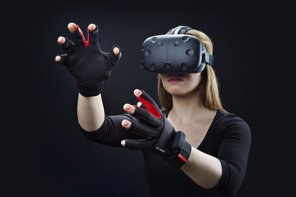

The Manus VR Glove is one of many devices providing haptic feedback for a more immersive experience.

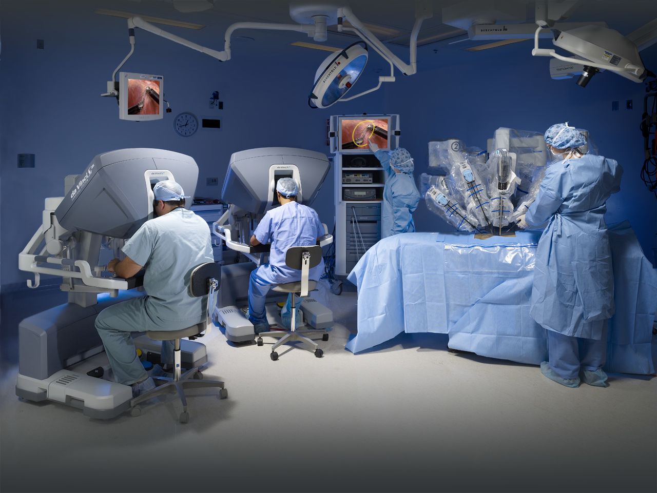

Intuitive Surgical’s da Vinci Surgical System employs advanced haptics allowing a surgeon to feel what he/she is doing despite the separation from the patient.

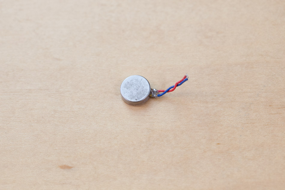

In addition to the cylindrical ERM vibration motors, the other form factor we have are coin vibration motors. These are flat, “pancake” (a common nickname) components.
Coin vibration motors also employ a rotating offset mass, only in a flat and smaller form factor that is fully enclosed, rather than exposed. Instead of a longer cylindrical shaft with a long axle and offset mass, the shaft is very short, and the interior contains a flat mass that is offset from the center of rotation (so that it can fit in the coin shape). Thus they are categorically also ERM motors by mechanism; however, it’s common industry practice for the exposed cylindrical vibration motors to be called ERM vibration motors and the coin form factor to be called Coin, or Pancake, vibration motors.

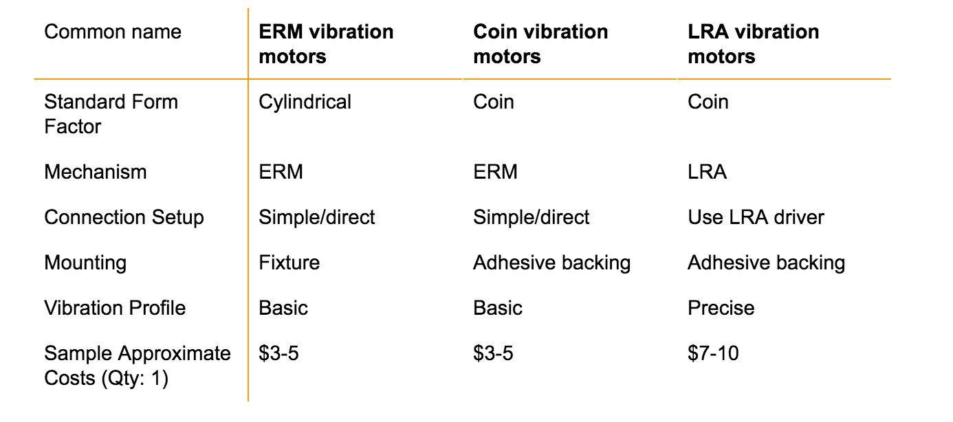

Summary of Different Vibration Motors
So are we classifying by form factor, or by mechanism type? And why the confusing standard for naming? Well, here’s the breakdown to set everything straight!
