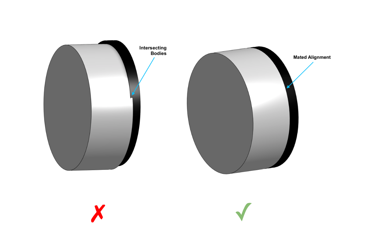

Assembly Files converted into .stl
Acceptable, but…
Assembly files converted into .stl files are sometimes processed through our Fictiv platform, but they can lead to serious issues down the road, especially if solid bodies intersect in the assembly file. Some slicers can calculate around the colliding meshes, correct the file, and proceed with slicing. In other cases, the software can generate support material in what should be a solid wall or misinterpret which surfaces are actually on the exterior of the part.  This may result in holes in your part and failed prints. Sometimes, the slicer can encounter an error that prohibits it from processing the file any further.
Although it’s not a 100% guarantee, properly mating bodies and avoiding colliding bodies in an assembly before exporting to an .stl can improve the chances of your file slicing successfully. Of course, submitting an .stl for printing that is one solid mesh is the best way to go.

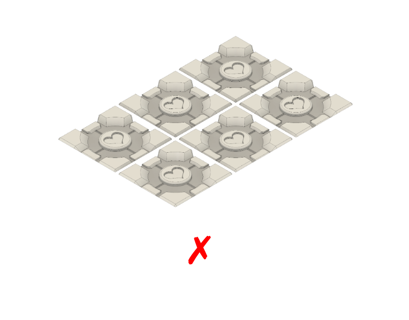

Several Copies of a Body or Unique Separate Bodies
UNACCEPTABLE
Files modeled with multiple floating bodies impact calculations of print time, cleaning time and slicing effort, all of which can lead to inaccurate pricing. They also limit our partners’ ability to orient the parts to optimize for quality and surface finish. These parts will not be produced and may result in order cancellation! Instead, please upload unique bodies as their own part during order configuration.
