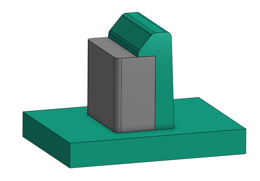

All joints have similar features and functions. In its simplest form, a snap-fit is a small protrusion — a male component (hook, bead, or bump) that is deflected during assembly to catch in a female component (a depression) on the mating part. The shapes of the male and female parts determine whether the joint can be separated and the force required to do so.
For this article, we’re going to focus on the cantilever snap fit, a simple yet effective cantilever-style joint. If you’ve reached the point in your career that you can admit you’ve “snapped,” well, entire books have been written (examples via Amazon here and here) about different types of snap-fit joint designs — other designs include annular snap joints and torsion snap joints. Yet, the cantilever style and its variations are both the easiest to design and the type you’re most likely to encounter.
snap fit design drawing
As you can see in the diagrams above, the cantilever snap joint is modeled by a fixed-free beam with a point-applied end load.

For injection-molded parts, remember that the mold dictates what’s possible.
  • Add draft: Include 1–2° of draft on both sides of snap arms and mating features to help the part release cleanly from the tool.
  • Use rounds and fillets: Sharp corners at the base of a snap arm create stress concentrations and increase the risk of cracking. A radius about half the wall thickness at the root works well. Corner rounds also reduce stresses during assembly for a smoother fit.
  • Keep wall thickness uniform: Avoid abrupt changes that can cause sink marks or warpage near the snap feature.
  • Plan for flow: Gate near the base of the snap to encourage even filling and reduce weld lines, and be mindful of part orientation to minimize warping.
Cantilever snap designs for injection molding
Core steel for molding a pass-through snap
Core steel for molding a pass through snap
