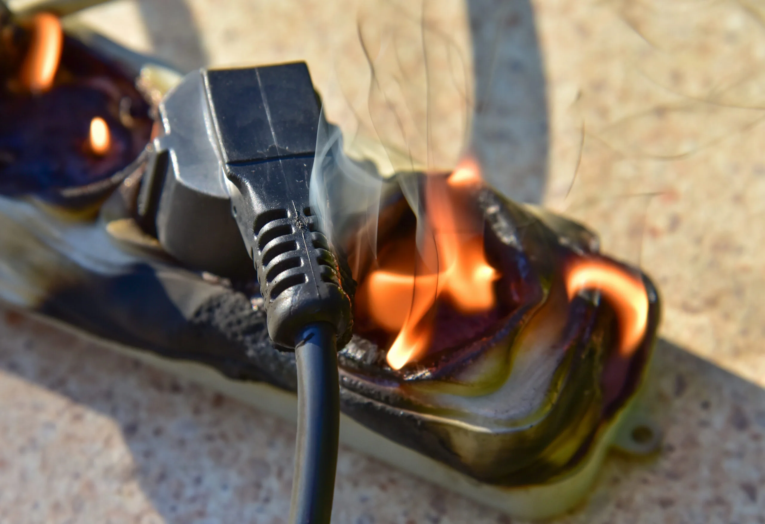

Flame retardant plastic UL 94

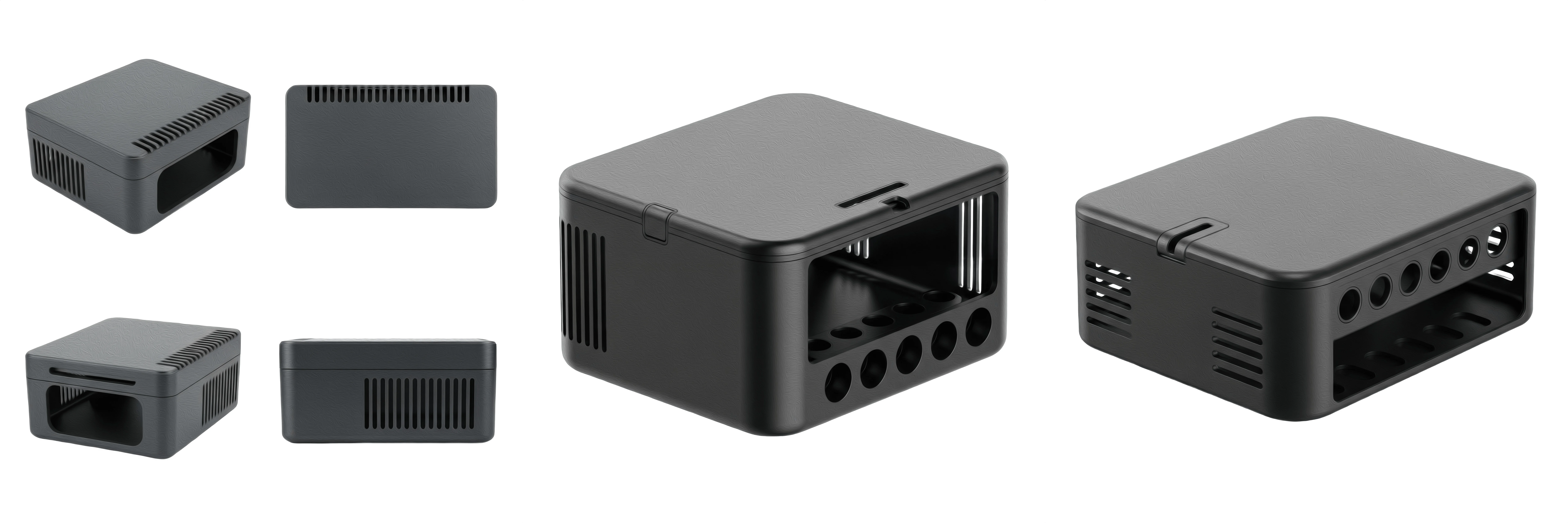

Most consumer electronics enclosures are manufactured to be flame-retardant
Most consumer electronics enclosures are manufactured to be flame retardant
