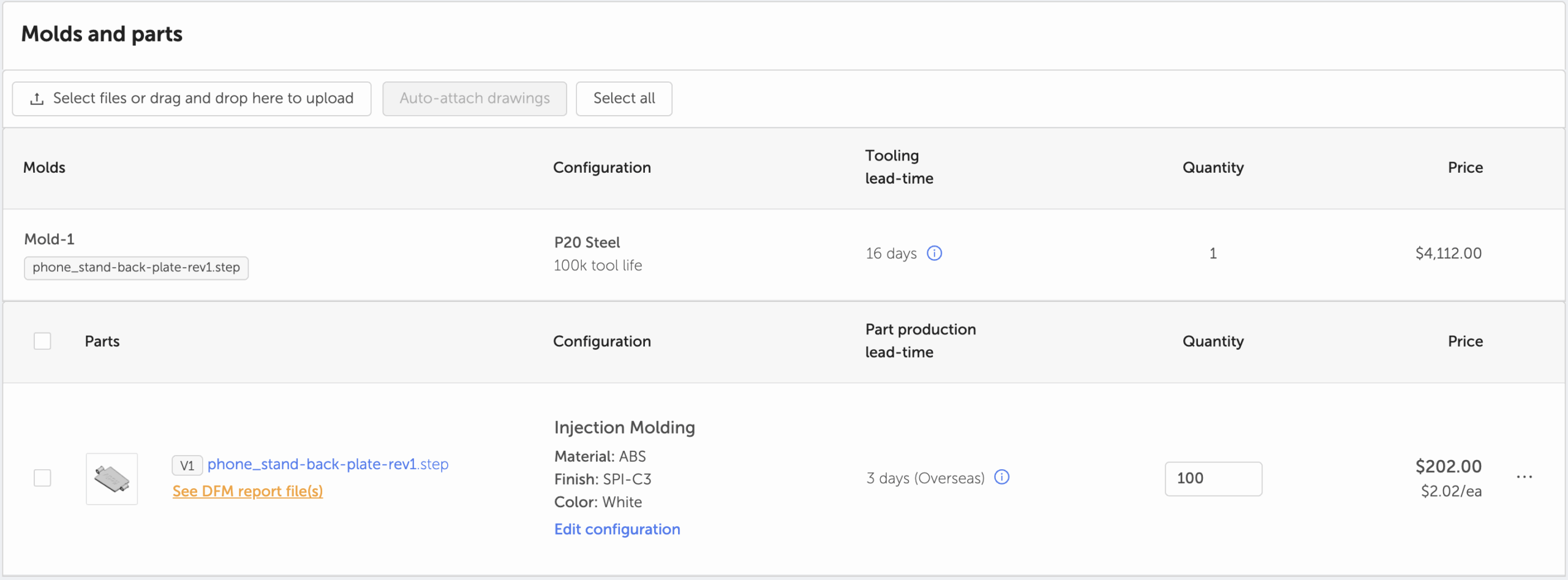

You will receive an email notification when the new DFM reports are ready for your review and approval. When you have DFM reports for a part, an orange button See DFM report file(s) will appear next to your CAD preview. Click See DFM report file(s) to access and download the DFM report files.

  1. Download the DFM report file from our platform
  2. Review the Fictiv analysis on each DFM topic in the DFM report. You may receive one of the following analyses on each DFM topic.
    1. The green box indicates that your part is acceptable on the DFM topic.
    2. The orange box indicates that some changes are recommended on the DFM topic. Please upload part or drawing revisions to your Fictiv quote if needed.
    3. The red box indicates that some changes are required on the DFM topic. Please upload part or drawing revisions to your Fictiv quote so that your part can be injection molded.
  3. If you have any questions about our analysis, please add comments to the corresponding slide in the PowerPoint file. Use Comments field under the Fictiv analysis or insert text and shape directly into the slide.
  4. After the Injection Molding tooling deposit is made, you will receive PEG reports (Final DFM). PEG stands for Parting line split, Ejection outline, and Gate location. These 3 aspects of tooling design require your approval before we begin manufacturing your parts. Please check the box “I approve the analysis on this slide” and enter the date of approval in the approval box in each slide of the PEG report (Final DFM) to provide your approval.
  5. After you review each slide and provide comments/approval, save the PowerPoint file and click Upload DFM report to upload it to our platform. Our quoting engineers will then either proceed with your quote or respond to your feedback by uploading a new DFM report.
