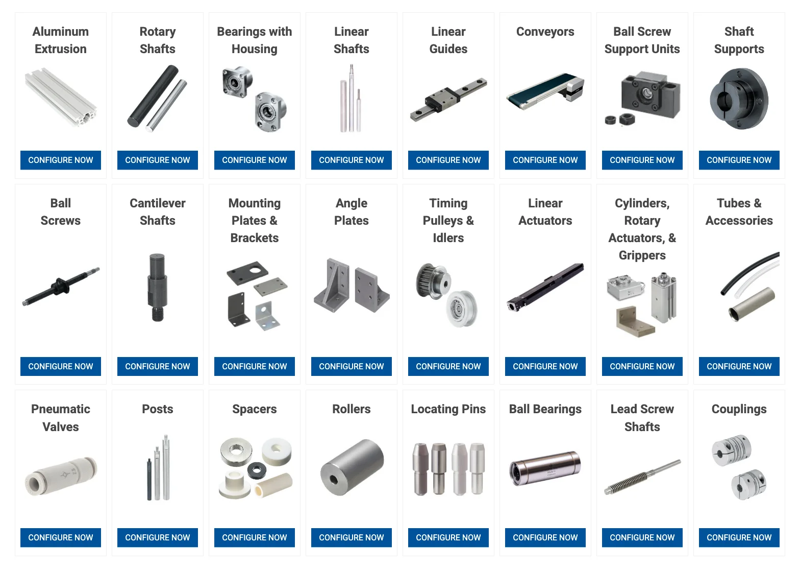

Configurable component options
What Are Configurable Components?
Configurable components are a subset of standard/off-the-shelf components. Unlike fixed catalog parts, configurable components allow engineers to select parameters such as dimensions, materials, finishes, or mounting features within predefined ranges.
Examples include:
  • Shafts and fasteners (with selectable length/diameter, material, hardness, and finish)
  • Plates with pre-defined hole patterns
  • Linear slide-rails and bearings, carriage assemblies, sensor attachments, and trips
  • Gearboxes and linkages
  • Gears and couplings
  • Chain and belt drive systems

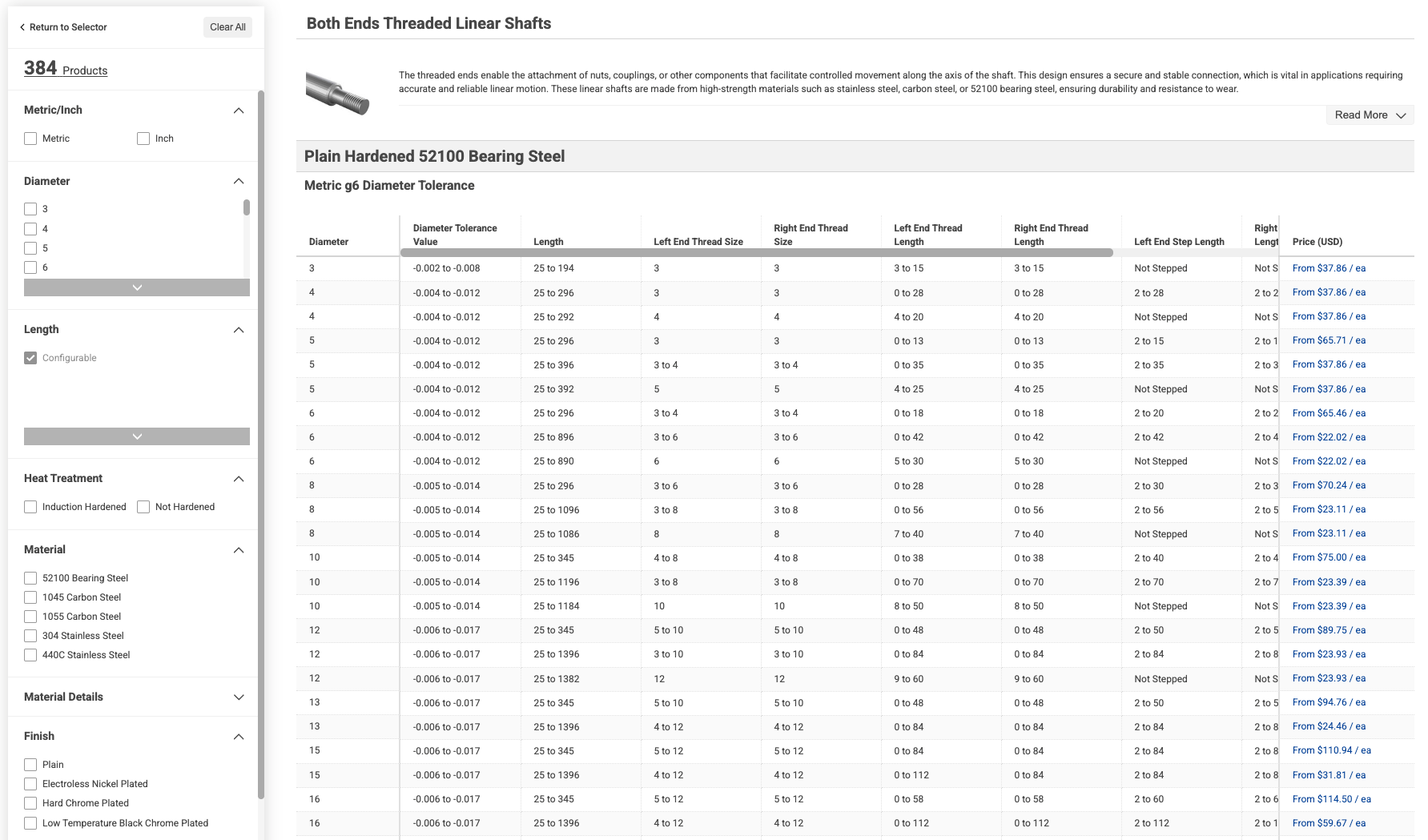

configuring a threaded shaft
Configuration of a threaded shaft

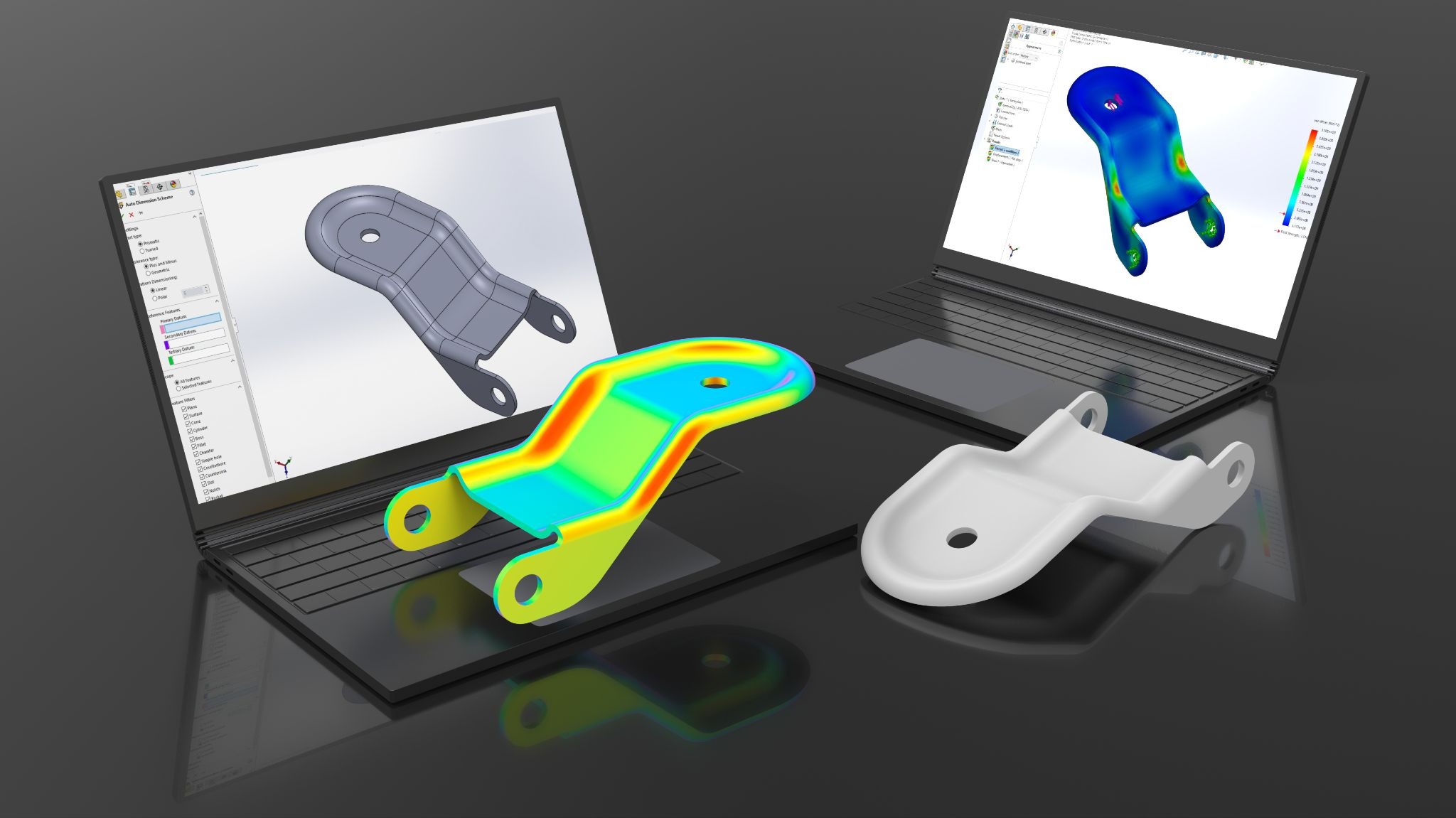

Custom part design
Custom part design

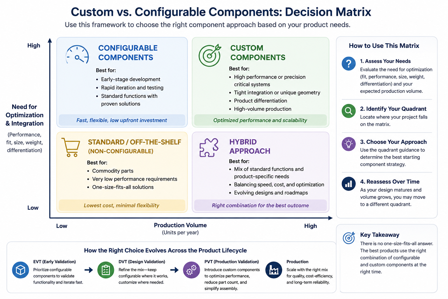

Product Life Cycle Considerations (EVT → Production)
Iteration speed is most critical in early-stage development, while later stages are dominated by cost and performance. Validation and low-volume production run faster and more smoothly with standard parts—locking in custom parts too early can increase risk and slow iteration.
Why Component Strategy Evolves Across the Product Lifecycle
The optimal component strategy changes as products move from prototyping to production. Engineering teams typically shift between configurable and custom components throughout the product lifecycle rather than relying exclusively on one approach.
  • Engineering Validation Testing (EVT): Configurable off-the-shelf components prioritize rapid iteration while cutting design time, tooling costs, and sourcing friction. Custom parts are introduced only when critical functionality requires them.
  • Design Validation Testing (DVT): A hybrid approach focusing on integration, reliability, and manufacturability. Teams use configurable components for standardized functions while introducing custom parts to improve packaging, simplify assembly, and optimize performance.
  • Production Validation Testing (PVT): Manufacturing readiness becomes the priority as custom components are used to consolidate assemblies, reduce tolerance stack-up, improve repeatability, and lower long-term production cost.
  • Production: An optimized mix for scale, component decisions must balance cost efficiency, supply continuity, and manufacturing stability. Custom components can cut total system cost by lowering part counts and simplifying assembly; configurable components remain valuable for sourcing flexibility and maintenance.
Hybrid Strategy: Custom + Configurable for Optimal Results
Most optimized products use a hybrid approach to balance cost, speed, and performance. This often means combining custom and standard components to produce a single product.
Configurable parts work well for structure, standard motion, and noncritical features. Custom parts make sense for core product function, differentiation, and integration. Used together, they support faster development cycles, lower overall cost, reduced technical risk, and better BOM optimization.
Many teams start EVT with configurable motion systems, brackets, and structural components to accelerate iteration. As production volumes increase and packaging constraints tighten, these parts are often redesigned into integrated custom assemblies.

Decision Framework: How to Choose the Right Approach
When deciding which components to use, these filtering questions can be useful to impose a structured approach to decision-making:
  • Is the function standardized? Does it match existing and parallel-product solutions?
  • Does the component/subsystem affect product differentiation?
  • What is the expected volume and/or break-even point (10 vs. 10,000 units)?
  • How stable and/or mature is the overall design or component?
As a rough guide: standard or low-volume applications favor configurable parts; unique functions at high volume favor custom; mixed requirements call for a hybrid approach. The matrix below provides a simplified framework for evaluating which strategy makes the most sense.
