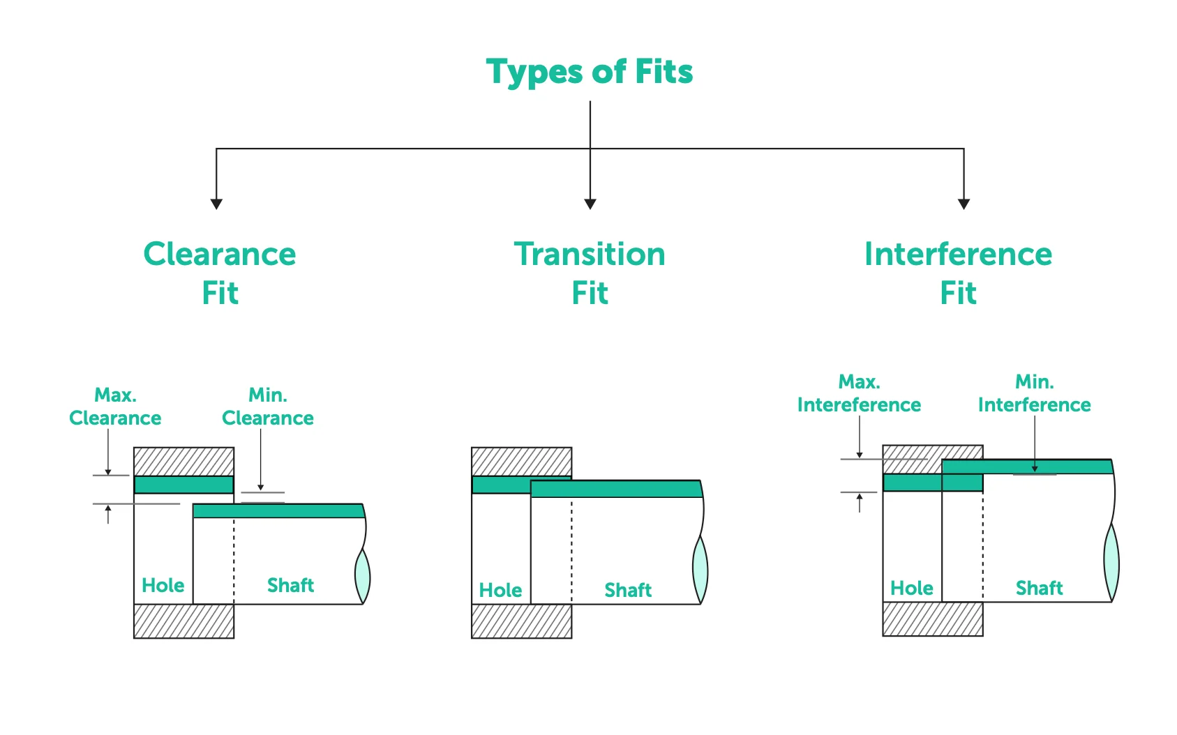

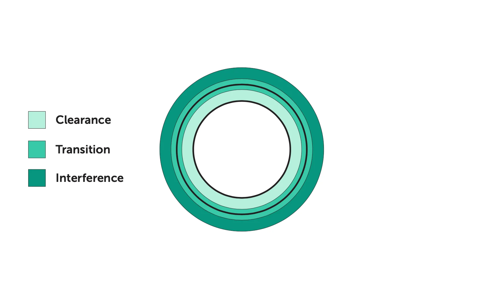

There are three primary types of fits in engineering: clearance, interference, and transition.
Types of Engineering Fits
Clearance Fit

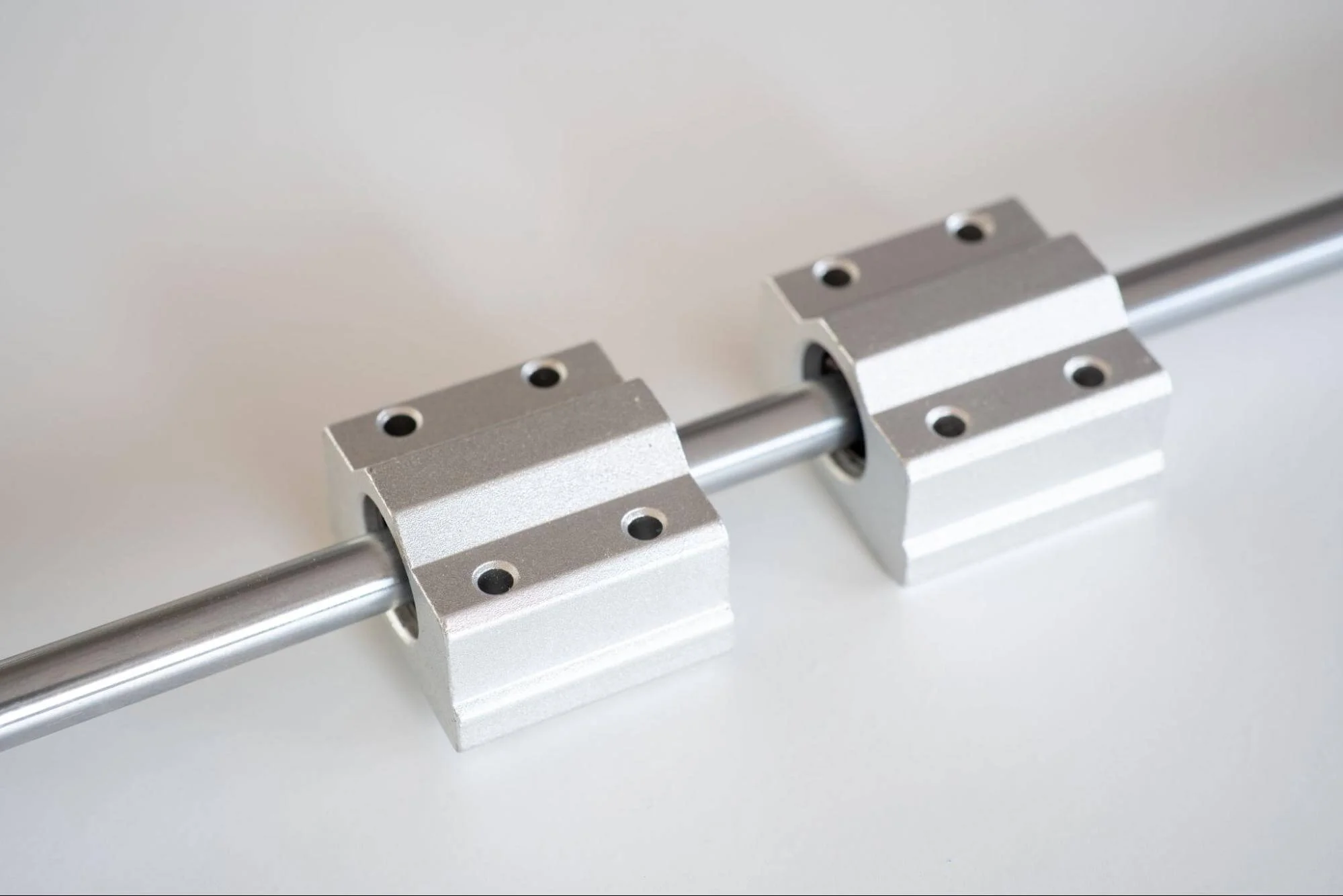

A clearance fit is the most common type of fit, where the hole is always slightly larger than the shaft, creating an intentional gap between the two parts. This gap, or clearance, allows for free movement without friction or interference and is controlled by the tolerances of both component features to ensure a smooth fit without excessive looseness.
There are various types of clearance fits including slide fit, easy slide fit, loose running fit, free running fit, and close running fit. These are based on the amount of clearance and looseness of the fit.
Clearance fits are ideal in applications where movement, rotation, or easy assembly is required. Examples include:

Interference Fit
An interference fit, also known as a press fit, occurs when the shaft is slightly larger than the hole, resulting in a tight, force-fit connection. The parts are assembled under pressure (or by applying heat to the hole, which temporarily expands it before fitting), creating an interference that prevents any movement between them. This fit forms a strong, stable bond that is often permanent or semi-permanent.

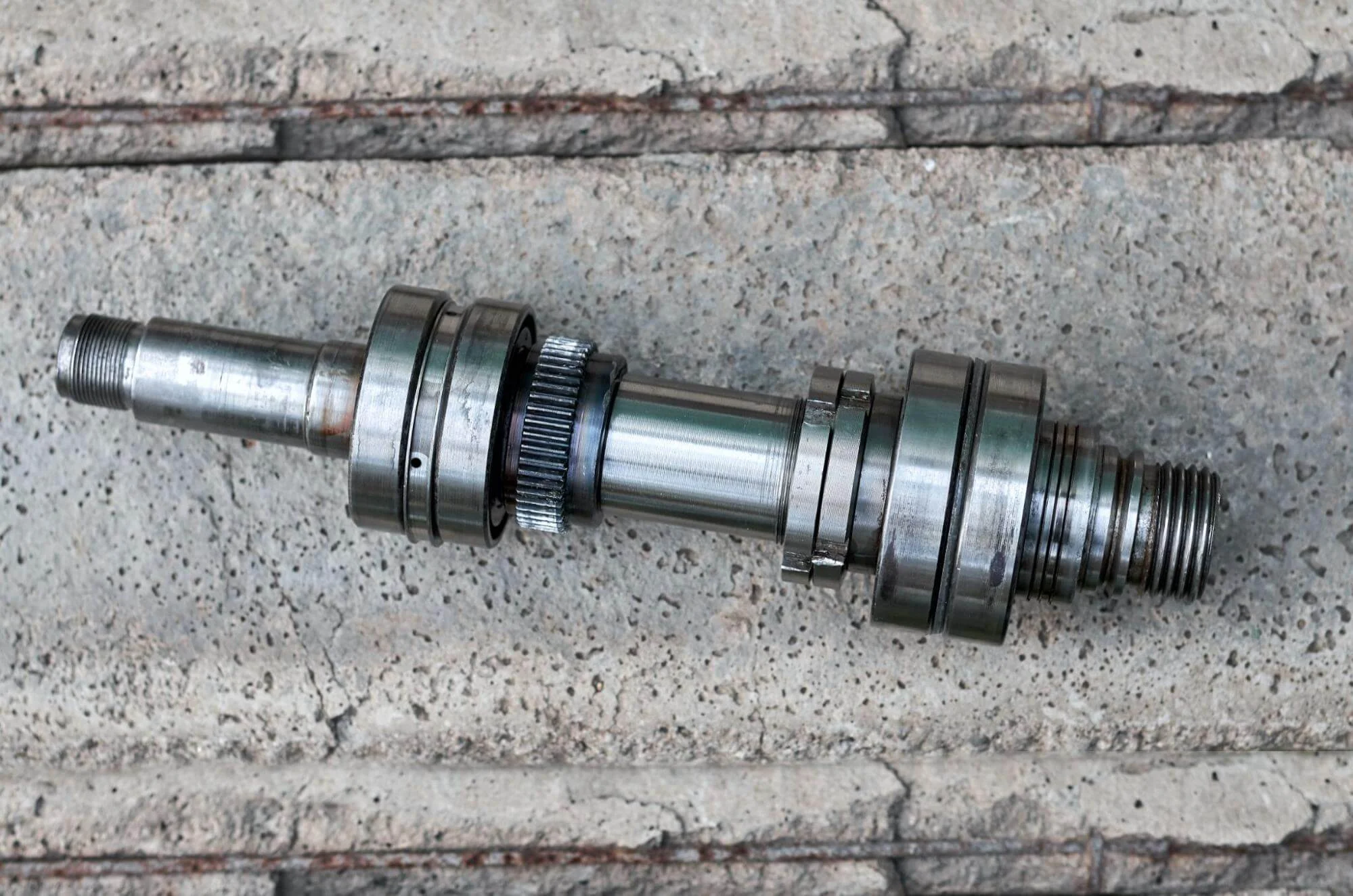

A shaft gear bearing typically uses interference fits.
Transition Fit
A transition fit strikes a balance between clearance and interference fits. Depending on the exact tolerances applied, it can result in either a small clearance or slight interference between the shaft and the hole.
This type of fit is used when precise alignment is needed, and parts must fit together tightly—but not permanently—allowing for minimal play and controlled movement.
