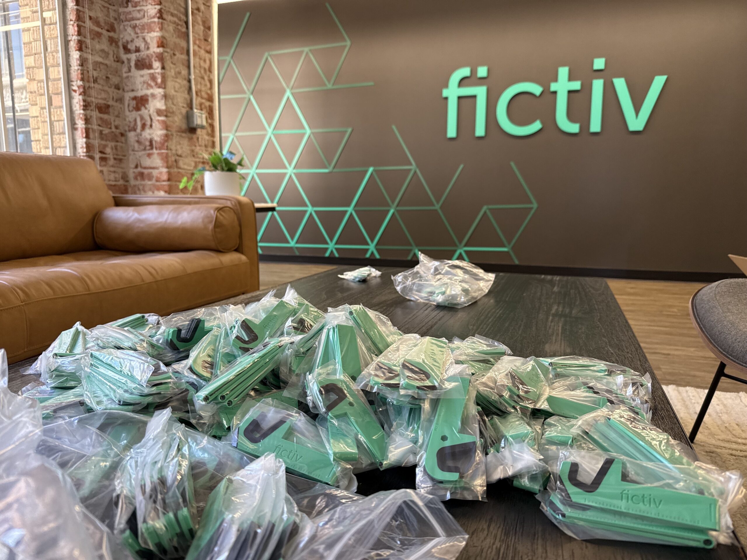

The boxes landed at Fictiv HQ, and the payoff was real. After months of designing, prototyping, and manufacturing, the final production run of our multi-tool phone stand is officially in our hands.
If you’ve been following the journey from a simple CAD file to a physical, multi-material product, seeing a table piled high with production-ready parts is the closing scene. For any product design engineer, getting the final parts is always a great feeling.
Fictiv made final parts unboxed

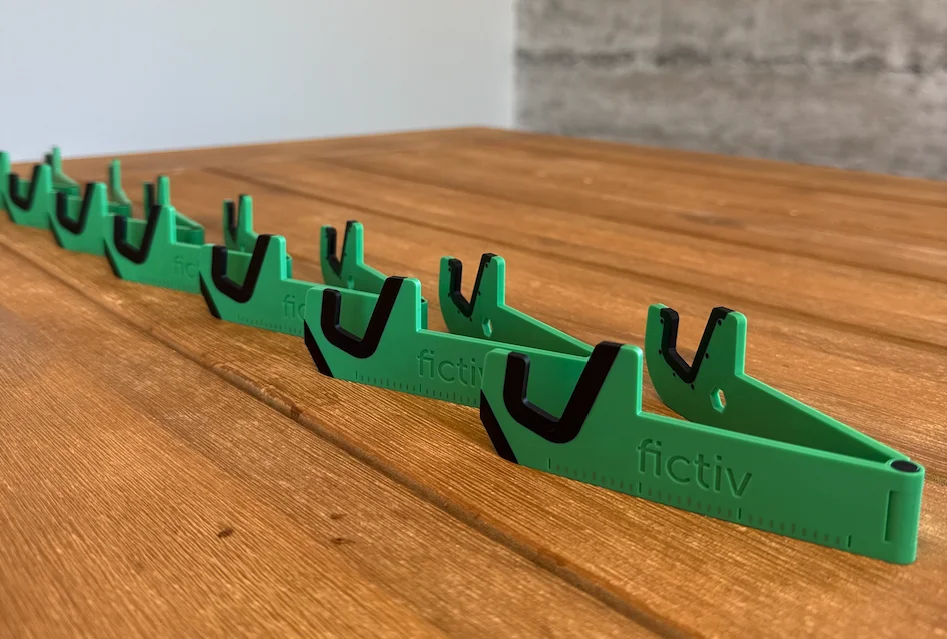

Here is a quick recap of how I tested the final parts to see if they actually live up to the design intent.
The Box Cutter Test
First things first—we had to get into the packaging. What better way to test the integrated box-cutting feature than by using the tool to slice open its own shipping boxes? The metal edge of the blade held up well and sliced through the tape with a bit of pressure. It’s not quite as sharp as a true knife edge, but you can take it through airport security.
The Phone Stand Test
The tool easily unfolds into a stable phone stand for vertical or horizontal viewing. I set up the stand on the conference table, popped a phone in, and used it to watch… well, our Fictivmade episodes, obviously. The overmolded TPU grip keeps the phone secure, preventing it from sliding around or falling out in both portrait and landscape mode.
The Hex Drive (Screwdriver) Test
Next up was the hex drive. I designed this to accept standard hex bits with a snug fit, turning the entire body into an ergonomic screwdriver. I grabbed a drive bit and used it to unscrew and tighten a screw on the back of a keyboard. Thanks to the overmolded grip and length, it gave plenty of torque without slipping or flexing the plastic core.
The Ruler Measurement Feature Test
I also tried out the integrated ruler feature running along the edge. Molded-in text can sometimes lose definition during injection molding, but these markings came out incredibly crisp, legible, and—most importantly—perfectly accurate when checked against a standard caliper.
The Speed Square Test
Injection-molded parts are highly accurate because the molds are CNC machined, and dimensions can be verified through various forms of inspection. The speed square, subtly integrated into the product’s “F” form, works well for quickly checking square corners.
The Hinge Stress Test
If you watched our earlier design iterations, you know we modified the hinge geometry to be more robust and stable. I cycled the hinge open and closed, even twisting it to try and break the snap pin. The modified hinge was solid, without loosening permanently.
The Pocketability Check
A multi-tool is most useful if you can actually carry it with you. For the final test, I tossed it in my pocket and took it back out a few times. Thanks to the slim, fold-flat design and rounded edge radii, it slips right into a front or back pocket without snagging or digging in when you sit down.
