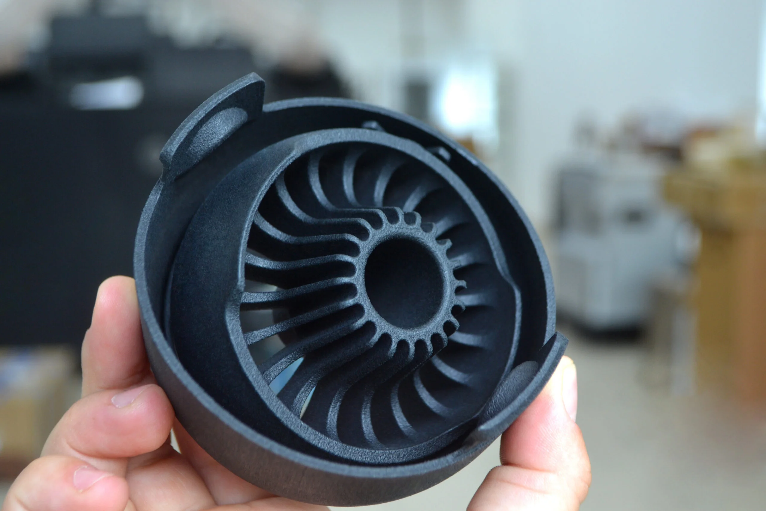

MJF and SLS are the processes most often considered for functional food-contact parts—and most often disqualified. PA12, PA6, and PP are all potentially FDA compliant in raw form, but both processes fuse powder into a grainy, microscopically porous surface that traps food particles and microorganisms.
Part manufactured with MJF 3D printing
MJF 3D-printed part with porous surfaces
Vapor smoothing and an FDA-compliant epoxy or silicone sealant can reduce and seal that porosity, but the sealant must be validated for the specific contact type, temperature, and cleaning cycle, and abrasion re-exposes the porous substrate underneath. Reasonable for prototyping or low-frequency contact—not for production equipment under frequent caustic cleaning.

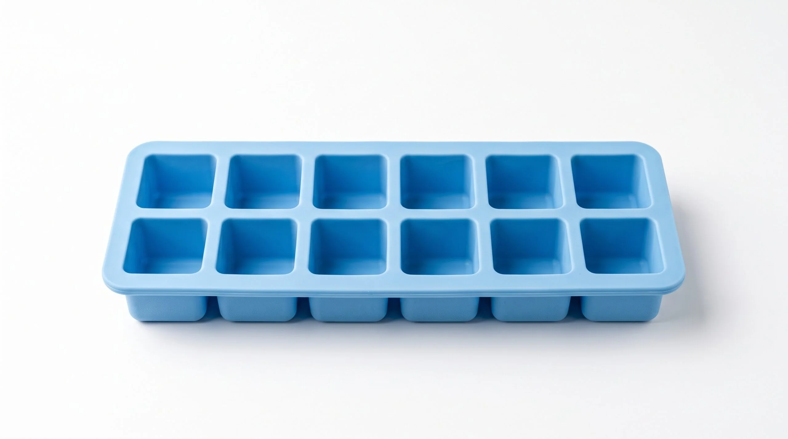

Injection molding is the most common, most established path to a production food-contact plastic part. FDA-approved food-grade resins exist across PP, HDPE, PC, PET, and POM (Delrin), all under 21 CFR 177—molded in a closed cavity from certified pellet, with no printing-driven porosity to manage.
The same logic covers elastomers: liquid silicone rubber (LSR) is FDA 21 CFR 177.2600 compliant and common in bakeware, seals, and gaskets, and food-grade TPU grades (BASF Elastollan FC, Covestro Texin) are compliant when injection molded—but not as standard 3D printing filament, which carries the same layer-porosity problem as FDM. Tooling cost and lead time are the usual objections, but low-volume injection molding with aluminum “bridge” tooling can produce 100–10,000 units at a fraction of the cost and lead time of steel production tooling.
