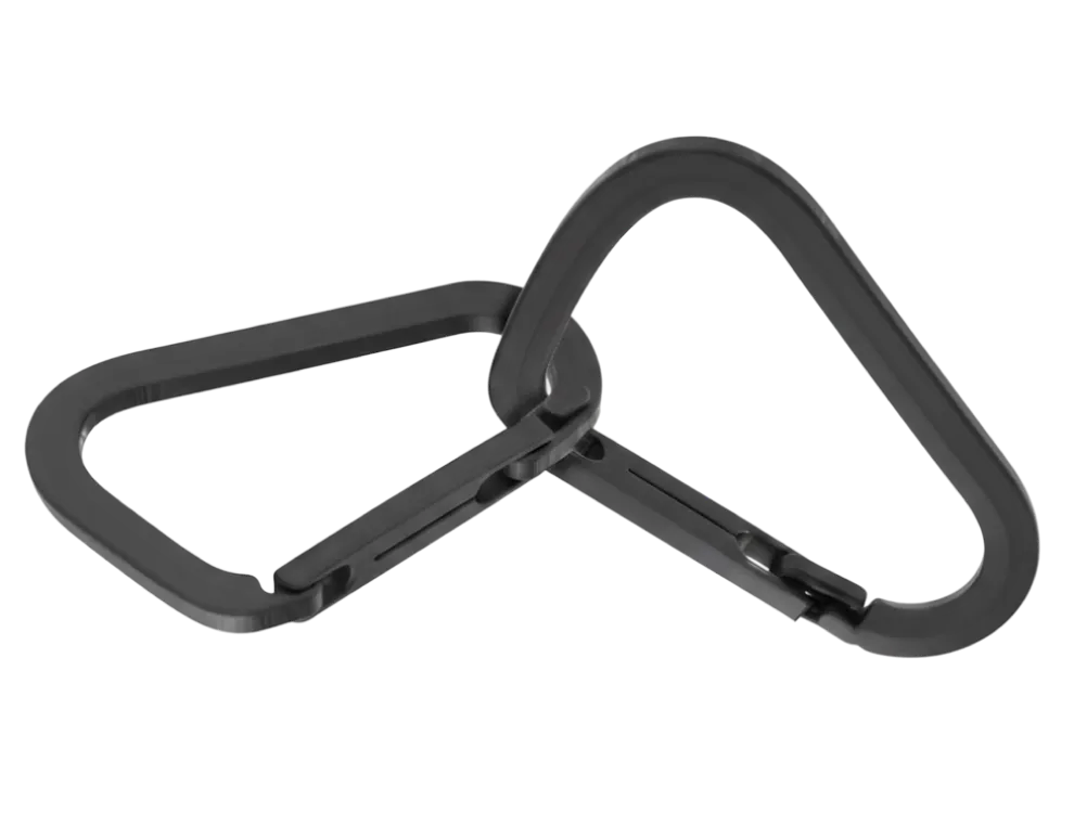

EPX 82 is a high-strength epoxy-based engineering material with excellent long-term durability and mechanical properties comparable to lightly glass-filled thermoplastics (e.g. 20% GF-PBT, 15% GF-Nylon). It is suitable for a variety of automotive and industrial applications such as connectors, brackets, and housings.
Extreme Toughness
Extreme Toughness Icon
Endurance
Ultimate Tensile Strength
84 MPa / 12000 PSI
Elongation at Break
n/a
Heat deflection temperature
130°C / 266°F @ 0.45 MPa
