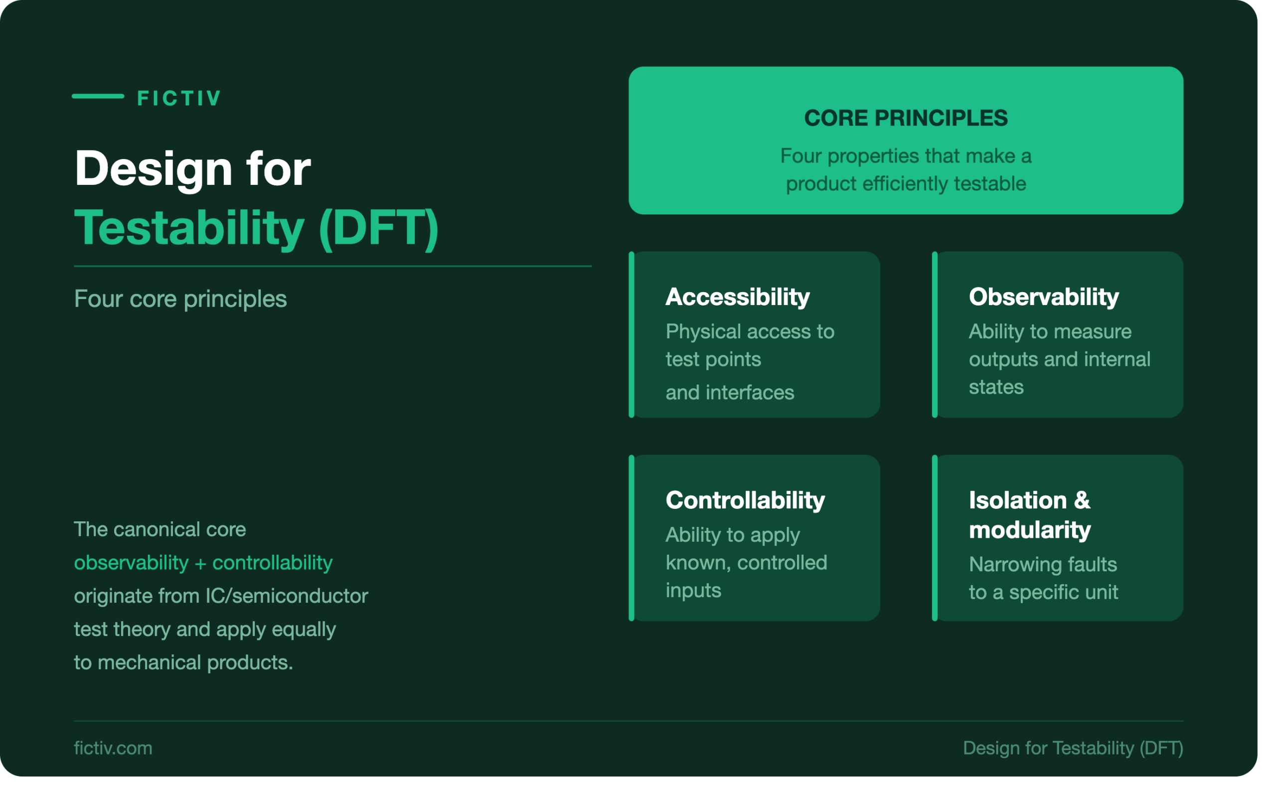

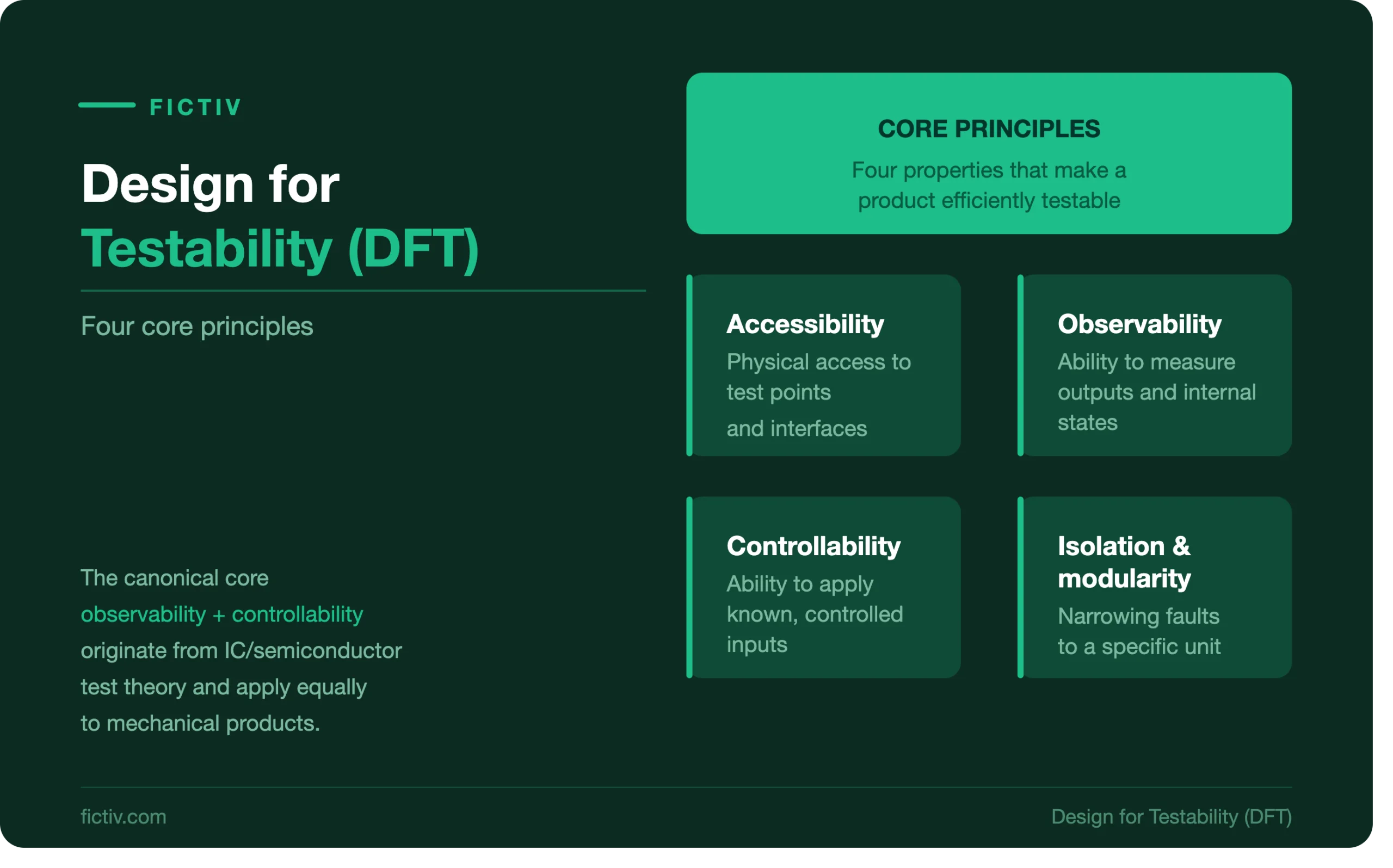

Fictiv Design for Testability DFT 4 core principles
Core Principles of Design for Testability
  1. Accessibility
The most fundamental testability problem in mechanical products is physical access. If a test probe, sensor, or torque transducer can’t reach the feature being measured, you can’t test it directly. In practice, this means providing clearance around critical interfaces for tooling and instrumentation, including dedicated test ports (pressure taps, electrical connectors, optical access windows) in early design, and designing assemblies so functional tests can be performed at intermediate stages rather than only after final integration.
Test points are the physical realization of accessibility: the locations where instrumentation interfaces with the product. An example is CMM inspection: reference datums must be positioned with sufficient surrounding clearance for a touch probe to reach them without crashing into adjacent features—a constraint that belongs in the tolerance model from the start, not discovered at inspection. A useful design review question: “How would I instrument this to measure its performance?” If the answer requires disassembly of adjacent systems, the design may need to change.
  1. Observability
Observability is the ability to infer a system’s state from its outputs. Good testability requires that the outputs you care about—force, pressure, flow, position, temperature, torque, vibration—are measurable without excessive setup or disassembly. Design choices that improve observability include integral measurement interfaces (pressure taps, thermocouple bosses, encoder targets, strain gauge bonding surfaces) and instrumentation ports between functional stages in fluid systems.
In practice this means designing for the specific shop-floor tools that will be used: for fluid manifolds, machining dedicated flat sealing faces so an automated pneumatic decay tester can achieve a repeatable volumetric seal; for rotating assemblies, milling flat target pads at accessible locations so a laser vibrometer can detect early bearing wear without disassembly. Where direct measurement isn’t feasible, the design should produce observable side effects—vibration signatures, torque profiles, flow curves—that correlate reliably with the functional parameter of interest.
  1. Controllability
A test is only meaningful if you can apply a known, controlled input and measure the response. Controllability problems arise when test inputs are coupled to other variables that are hard to isolate—a bearing’s friction is simultaneously influenced by preload, temperature, and lubricant state—or when the product’s configuration at test time is ambiguous (seals not fully seated, fasteners not at final torque).
Improving controllability often means adding interface features that allow the test system to command specific inputs: hydraulic or pneumatic ports with known impedance, electrical connectors for built-in self-test (BIST) commands, or mechanical interfaces that accept calibration loads—for example, a torque fixture that applies a repeatable input load through a defined interface so friction measurements aren’t affected by part orientation.
  1. Fault Isolation and Modularity
When a test fails, the key question is: What failed? If the test only tells you the assembly failed without identifying which subassembly or component is responsible, technicians must speculate—and speculation is expensive.
Good testability enables fault isolation through modular architecture, where each subassembly can be tested independently at defined interfaces, and through explicit intermediate test points between functional stages that allow a divide-and-converge diagnostic approach. FMEA during design—a core tool in Design for Reliability (DFR)—should identify the most likely failure modes and confirm that the test plan can distinguish between them.
DFT in Electronics and Semiconductors
In electronics, DFT is a mature discipline with established techniques: boundary scan (JTAG/IEEE 1149.1) allows digital logic to be tested through a serial scan chain even when physical probe access is impossible on dense PCBs; Built-In Self-Test (BIST) embeds logic that exercises and verifies its own functions on command; and Automatic Test Pattern Generation (ATPG) software generates test vectors targeting specific fault models. In semiconductors, DFT sign-off is a required gate before tape-out, so test engineers work alongside digital designers from the first RTL commit.
The same “testability is a design responsibility” principle applies to mechanical engineering. For mechatronic products, the challenge is coordinating testability across both domains: the mechanical architecture must expose mechanical parameters, the electronics must expose computational states, and the test strategy must integrate both.
