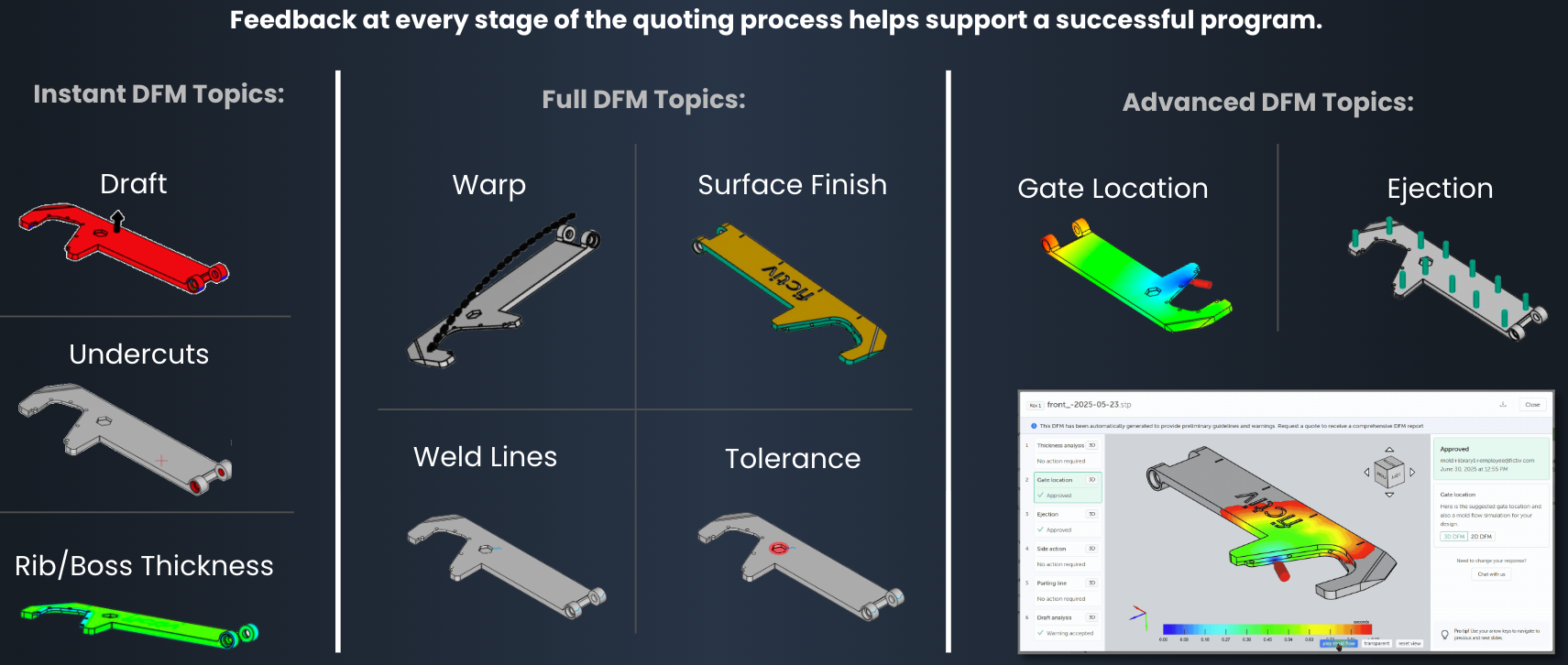

Top DFM Tips for Injection Molding
Presented by Robbie Long, Injection Molding Product Manager
Design for Manufacturing (DFM) is the foundation of efficient, high-quality injection molding. As Robbie explained, incorporating DFM feedback early in the design and quoting process helps prevent costly rework and ensures that each part can be manufactured reliably and repeatably.

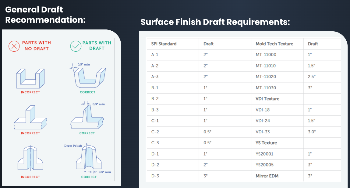

Ejection and Draft Angles
If a part doesn’t eject cleanly, it can cause major problems.
Draft recommendations for various surface finishes.

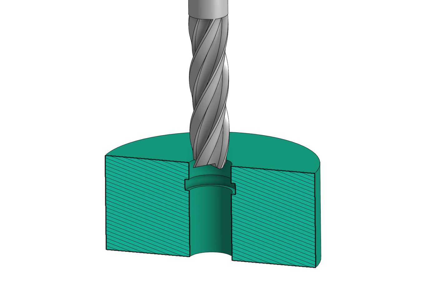

CNC Machining DFM Exceptions
  • Deep Holes: Permissible for through-holes or non-threaded reliefs.
  • Undercuts: Necessary for O-ring grooves or keyways—just plan for tooling costs.

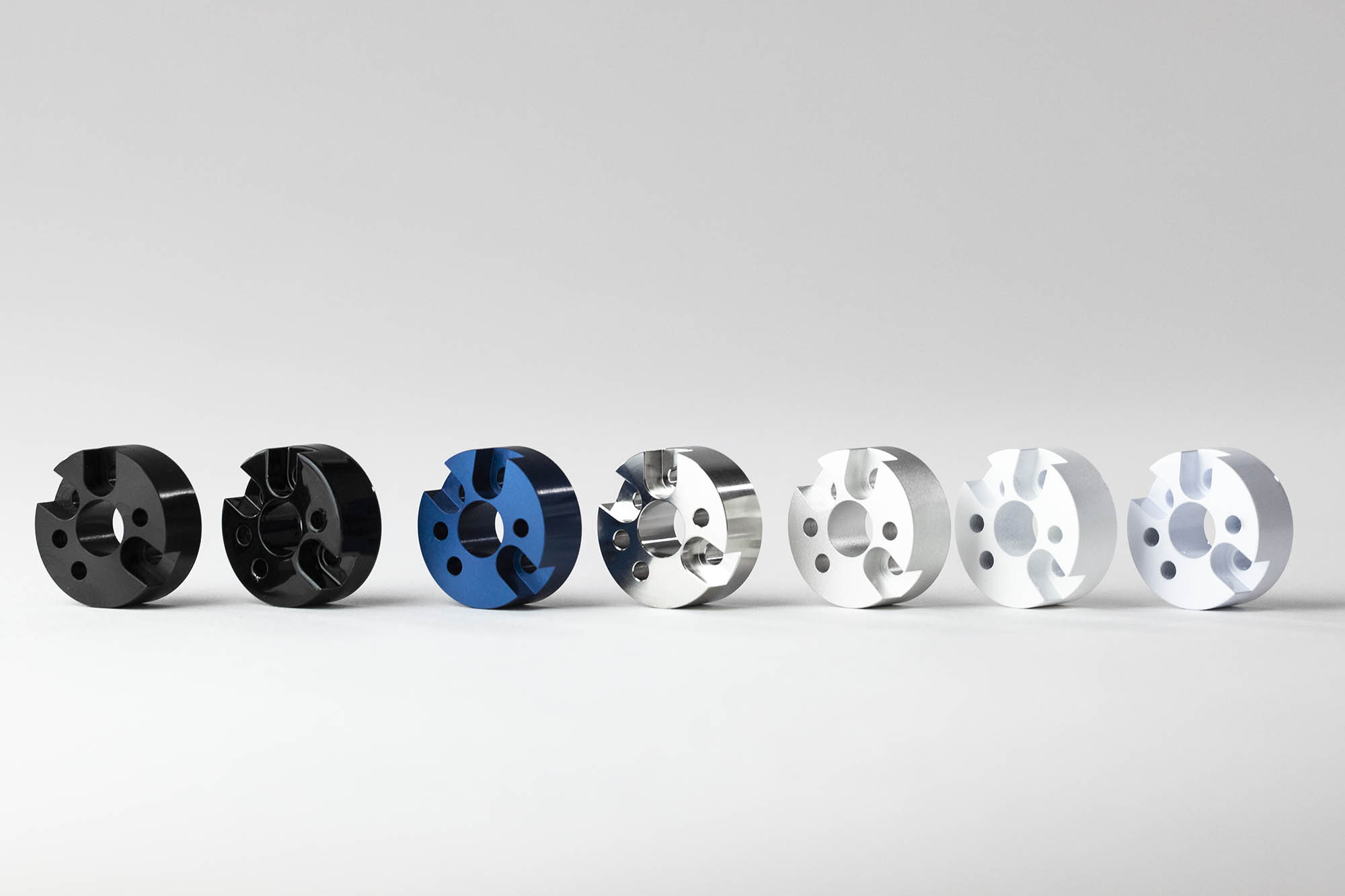

Anodizing: The Most Common Aluminum Finish
Anodizing forms a corrosion-resistant oxide layer that becomes part of the metal itself.
  • Type II (Sulfuric Acid): For decorative and moderate wear resistance.
  • Type III (Hardcoat): For extreme durability and abrasion resistance.
  • Alloy composition affects color: 6061 typically appears gray; 7075 often produces bronze tones.
