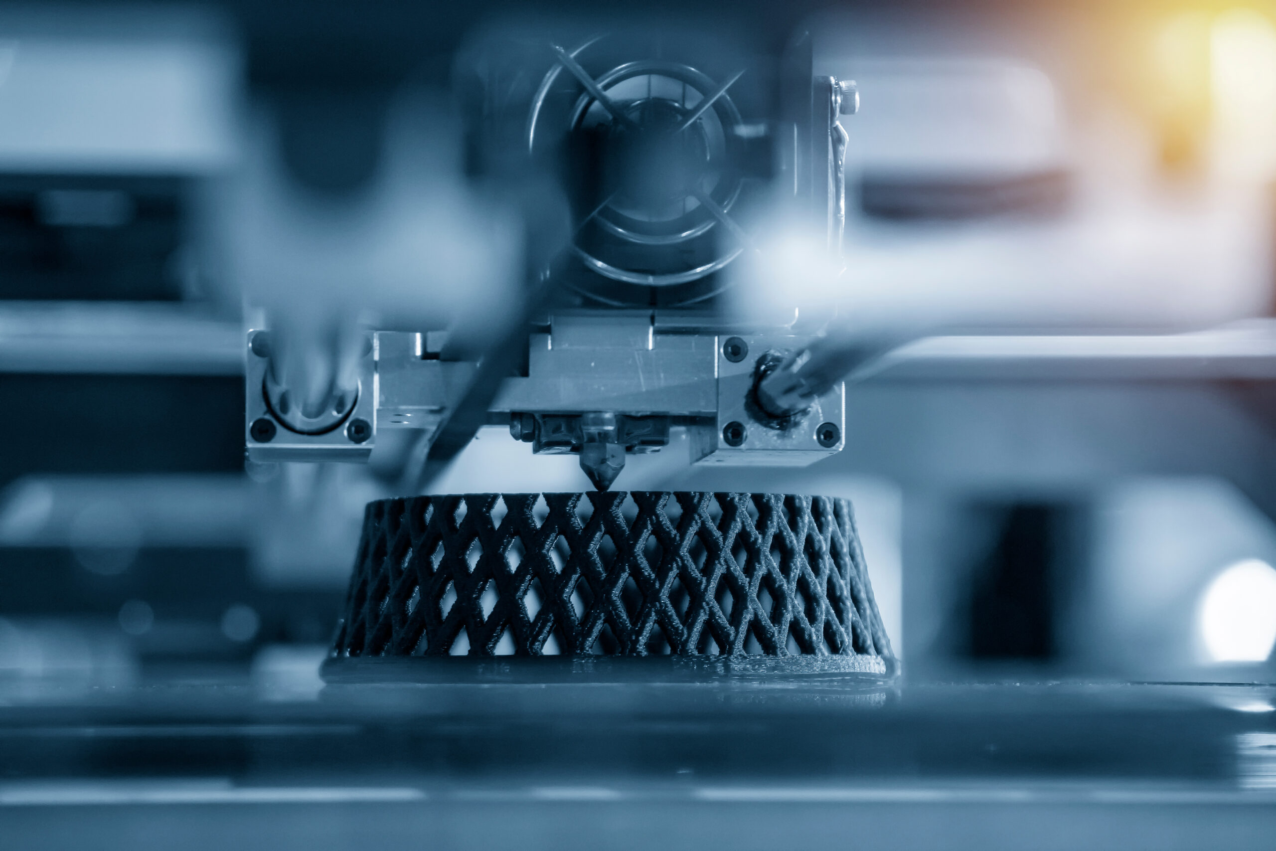

Large-Format FDM (Fused Deposition Modeling)
Large-Format FDM is effective for fabricating lightweight manufacturing tooling, jigs/fixtures, and even massive functional parts like robotic end-effectors and structural housings.
By scaling up to wide-diameter nozzles (typically 0.6 mm to 1.2 mm or larger) and high-diameter filament inputs, industrial FDM systems can process high-performance, carbon fiber-reinforced composites to deliver heavy-duty structural components. However, scaling a filament-fed FDM system up introduces a major thermodynamic bottleneck: the volumetric extrusion limit. The maximum print speed is fundamentally governed by how quickly heat can penetrate the core of a solid polymer wire as it passes through the hotend.
To maintain structural integrity across a 500 mm+ build without stalling the drive gears, industrial large-format FDM printers utilize extended melt-zone hotends, dual-element heating arrays, and forced-convection active build chambers. These active thermal environments are critical for managing the inter-laminar bond strength of the part. If the ambient chamber temperature drops too far below the material’s glass transition temperature, the previously deposited bead will cool and solidify completely before the next layer arrives. This prevents the polymer chains from cross-linking and diffusing across the layer interface, resulting in brittle parts prone to splitting under load.
For large-scale high-performance thermoplastic builds, maintaining tight control over this localized thermal gradient is the only way to prevent warping and ensure true structural performance.

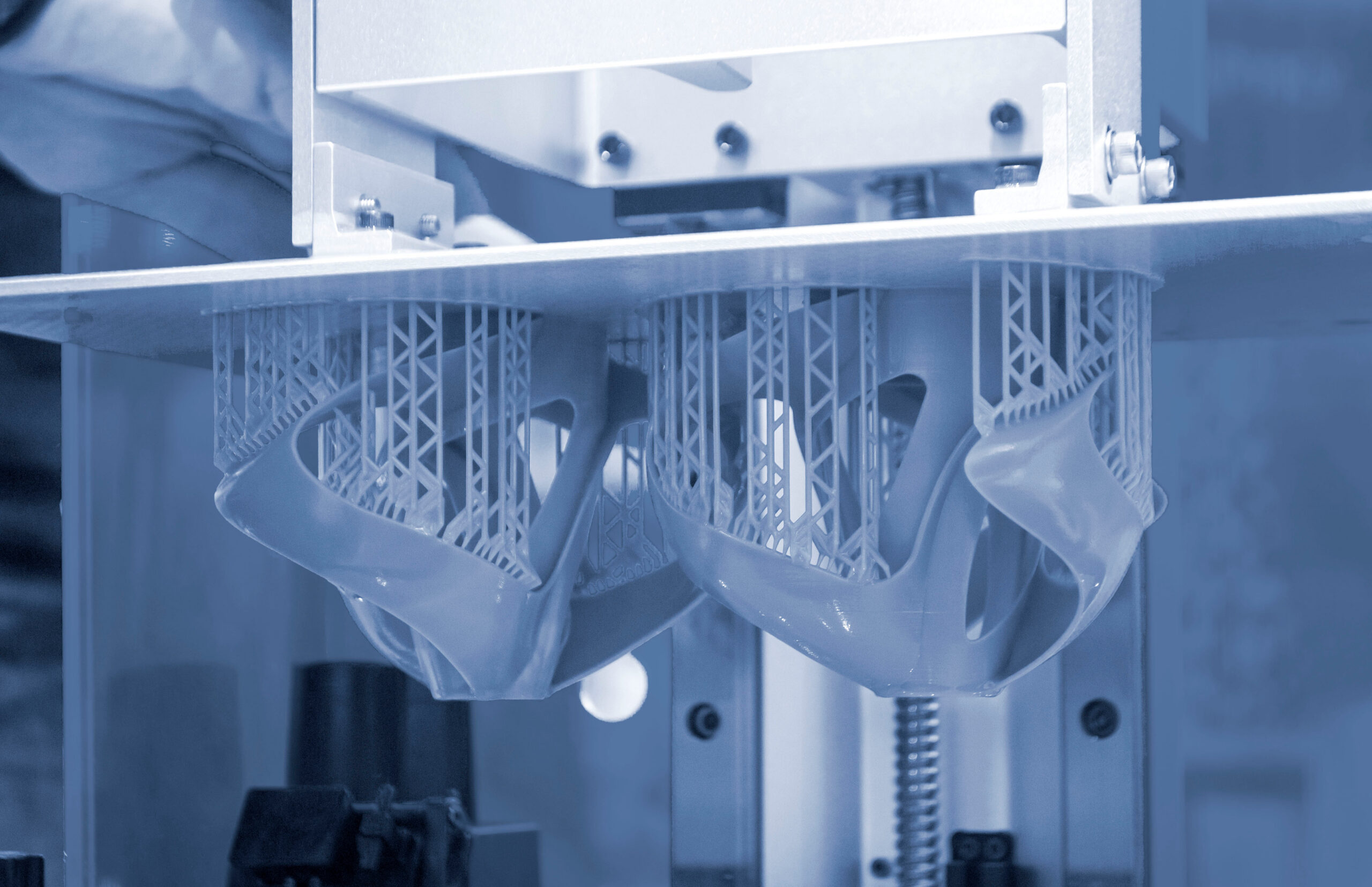

Large SLA (Stereolithography)
Large SLA printing is the best option for oversized components where premium surface finishes and feature resolutions take priority. Using precise UV laser systems to cure liquid photopolymer resins, large SLA produces aesthetic prototypes, clear fluidic housings, and master patterns for low-volume urethane casting without visible layer lines.
However, scaling a vat-based photopolymerization build-up introduces hydrodynamic and mechanical challenges that don’t exist on smaller platforms. Every time a new layer is cured, the build platform lifts vertically to break the vacuum seal between the freshly cured resin and the vat’s bottom membrane. For large-surface-area parts, these peel forces scale nonlinearly. If your geometry doesn’t feature robust support anchoring and deliberate cross-sectional optimization, these separation forces can tear the part completely off its scaffolding or warp fine features.
Engineers must also account for low green strength. When an SLA part is inside the liquid resin vat, it exists in a partially cured, gel-like state before its final run in a UV post-curing oven. Oversized, heavy, or long overhanging features are highly susceptible to sagging, bowing, or shifting under their own weight during construction. To mitigate this green-state deflection, large SLA parts require specialized, high-density support webbing and localized wall variations designed specifically to resist gravity and peel-line dynamics.
