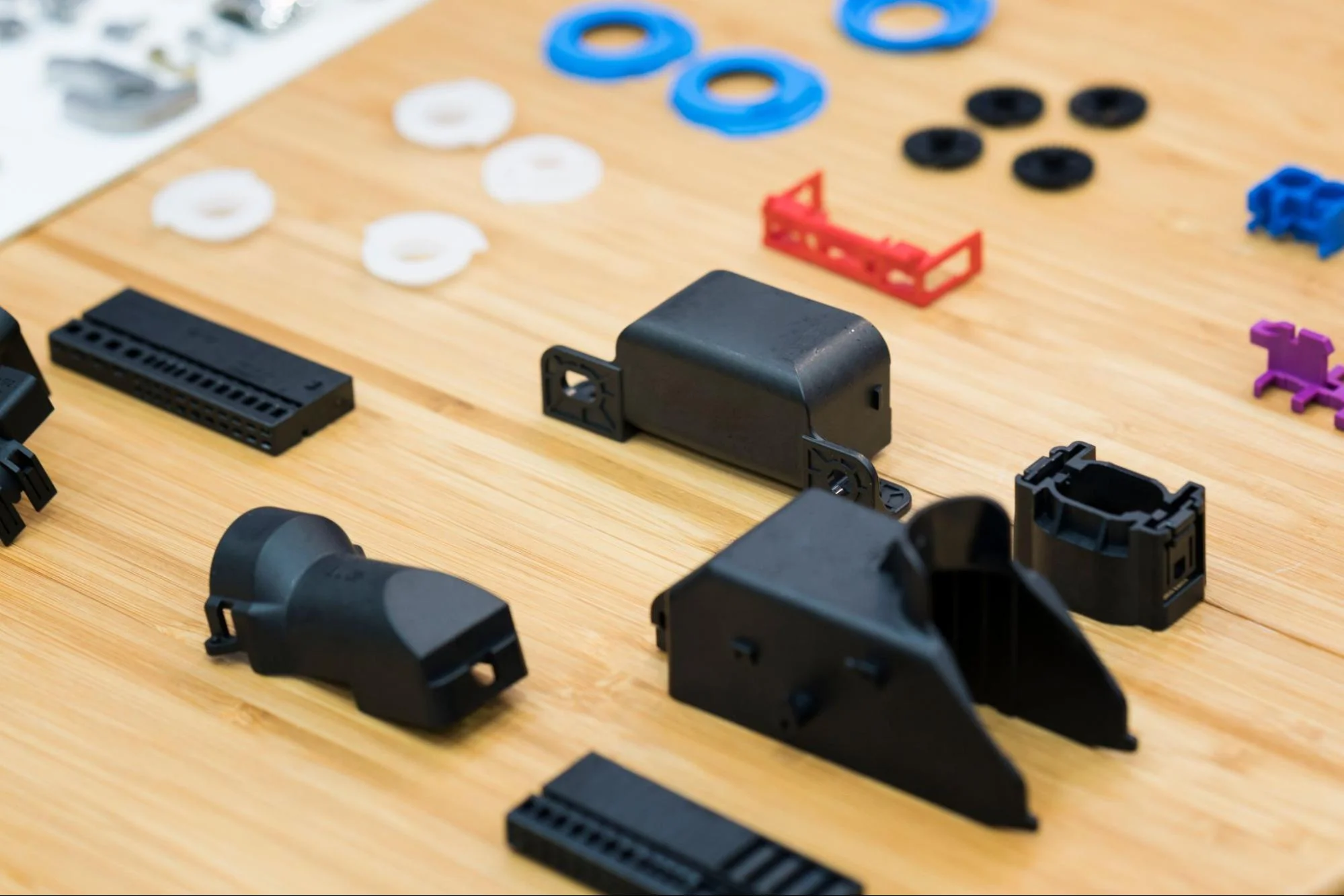

3D Printing (Additive Manufacturing): Fast and Flexible
Best For: Conceptual prototypes, complex geometries, and tight timelines.
3D printing is a go-to technology for creating intricate designs and fast iterations. Using materials like photopolymer resins, nylon, or even metal, 3D printing can bring your vision to life in record time.
3D Printing Advantages:
- Rapid turnaround: Ideal for last-minute design adjustments before CES.
- High detail: Modern 3D printers can produce smooth surfaces suitable for show-quality finishes.
- Design flexibility: Handles complex geometries and internal features that are challenging with traditional methods.
3D Printing Applications:
- Unique design elements for consumer tech.
- Early-stage mockups for user feedback.
- One-off or low-volume parts.
With post-processing techniques such as sanding, polishing, and painting, 3D-printed parts can achieve a professional, production-ready appearance.

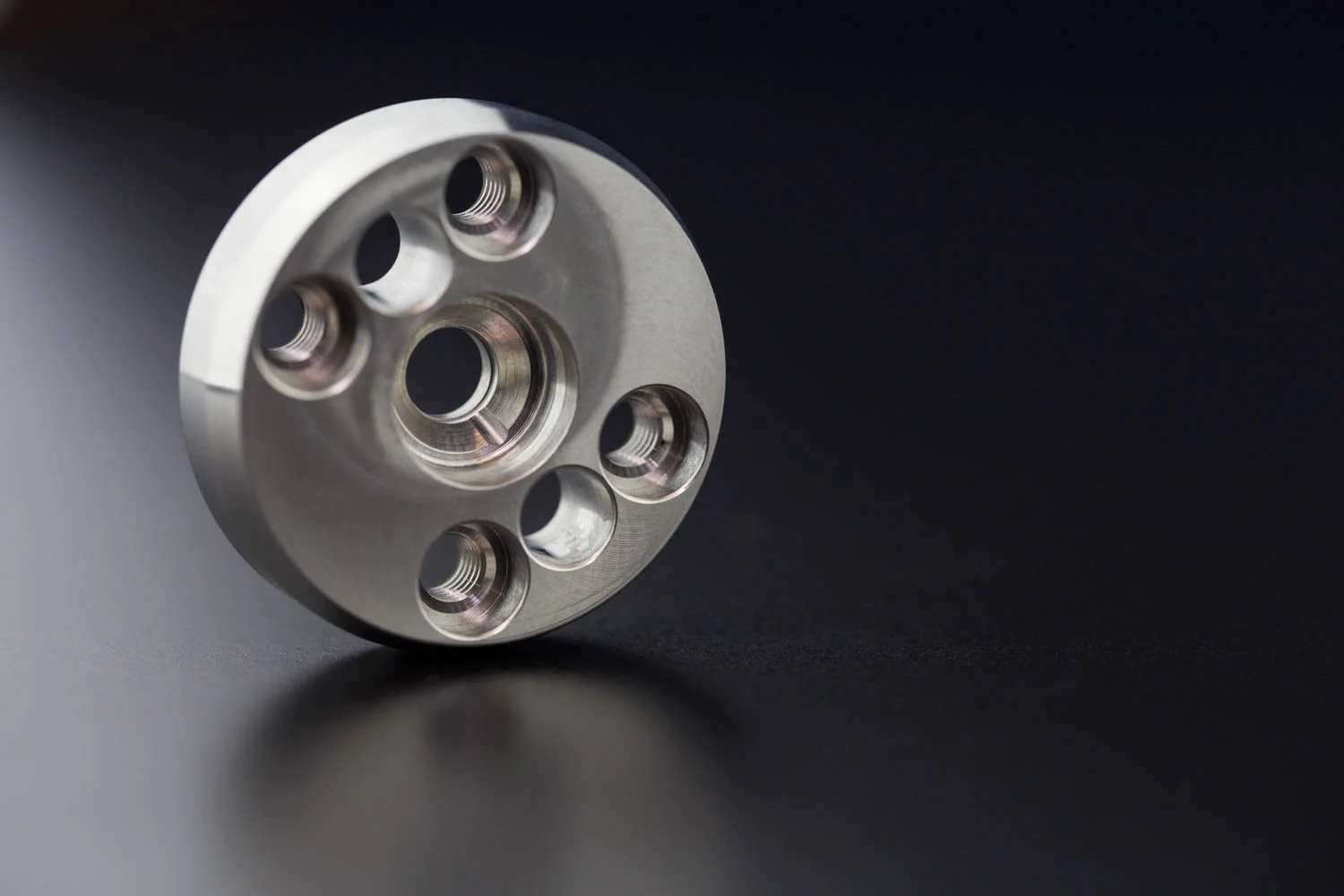

CNC Machining: Precision in Every Detail
Best For: High-strength parts, precision-fit assemblies, and premium aesthetic finishes.
CNC machining delivers unparalleled accuracy and surface quality, making it an excellent choice for CES-ready mockups that need a high-end look and feel. This subtractive process works with metals, plastics, and composites, allowing manufacturers to create durable, realistic prototypes.
CNC Machining Advantages:
- Superior precision: Tolerances down to ±0.001 inches.
- Versatility: Works with aluminum, stainless steel, ABS, and more.
- Polished appearance: Milled parts can be anodized, polished, or powder-coated for a show-stopping finish.
CNC Machining Applications:
- Metal enclosures for electronics.
- Wearable device prototypes.
- Structural components that must withstand functional testing.
If you’re looking to combine functionality with aesthetic appeal, CNC machining is a prime choice.

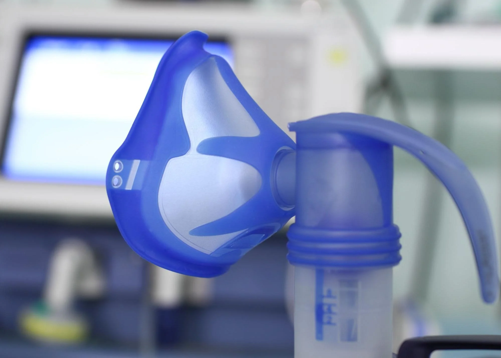

Vacuum Casting Urethane: Low-Volume Production with a Polished Look
Best For: Small runs of plastic components that replicate injection-molded quality.
Vacuum casting uses silicone molds and urethane resins to produce highly detailed replicas of master patterns. It’s perfect for creating multiple mockups without the expense and lead time of injection molding.
Vacuum Casting Urethane Advantages:
- Cost-effective: Ideal for low-volume production.
- High detail: Replicates fine textures and complex shapes with excellent fidelity.
- Material variety: Simulates rigid, flexible, and transparent plastics.
- Ability to create overmolded parts relatively quickly.
Vacuum Casting Urethane Applications:
- Plastic housings for devices.
- Transparent components such as screens or lenses.
- Ergonomic models for handheld gadgets.
The ability to reproduce fine details with a polished surface finish makes vacuum casting a reliable choice for CES prototypes.
