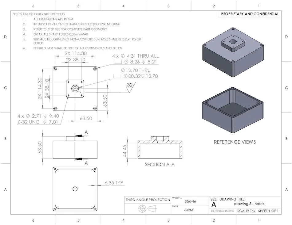

When using Fictiv, uploading a 2D drawing to your quote on the platform is the best way to do this. The following tips will help ensure that your drawing reflects your intended design.
Example of a well laid out engineering drawing. Read a step-by-step article here for more information
Example of a well laid out engineering drawing Read a step by step article here for more information
1. Give a Tolerance
The phrase “slip fit” and “press fit” are pretty universal and intuitive, but they’re not numeric tolerances. In simple cases, where it’s OK to leave the sizing of a dowel pin hole up to the discretion of the machinist, using these callouts for a dowel pin hole is fine. But if you have a lot of parts that may need to be made at multiple shops, or have press fit holes close to the edge of a part, a specific tolerance can ensure consistency and prevent accidental deformation of your part.
Providing either a numeric tolerance (ex .125” +/-.002) or a tolerance class like those found in ISO 286 (ex. 5 mm H7) is the way to go. With a drawing including, Fictiv can hold tolerances as tight as +/- 0.0002”. You can find our full tolerance standards here.
2. Be Clear with Your Callouts
Under-specified callouts in a drawing can lead to confusion about the intended nature of a hole. For example, the phrase “M6” on a drawing could mean three different things: an M6x1 threaded hole, an M6 clearance hole, or a hole toleranced to M6 per ISO 286. And we’ve seen drawings that have all three of these types of features on the same part. Giving a fully defined callout, like “M6x1 6G threaded hole”, “M6 clearance”, or “ 6 mm M6 (-.001/-.009)” will ensure the parts are made to the specifications you need.
3. Consider Your Hole Depths
Make sure to consider the depths of the holes in your part, not just the diameters. Blind threaded holes for a screw, for instance, need additional depth below where the thread ends to allow for tool clearance. So if you need 0.5” of thread for a screw to fit in to, the hole needs to be deeper than 0.5”. If you’re pressing in dowel pins, there also needs to be additional depth below the bottom of the pin, to allow space for the air stuck inside the hole to be compressed.
4. Label Holes
In large parts with lots of different types of holes, such as a base plate that has multiple parts pinned and screwed to it, it can be difficult to keep track of every hole. A callout such as “¼-20 thread, 35 places” can be confusing, unless all of those 35 holes are in a clear, easy to see pattern. Using hole tables or lettering the different types of holes on a drawing (e.g., “All holes labeled A are ¼-20 threads, all holes labeled B are .25”-0/-.002), can be a much cleaner way to accomplish this.

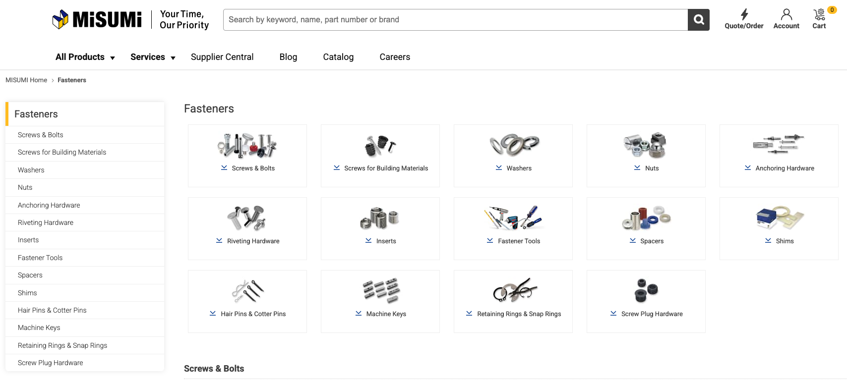

The most important thing to include is a clear definition of what hardware needs to be installed. The easiest way to do this is to give the McMaster Carr part number for what it is you want installed. McMaster Carr is currently Fictiv’s source for hardware, as their quick turnaround times ensure our manufacturing partners can meet our quoted lead times.
McMaster-Carr is a great resource for sourcing hardware
McMaster Carr is a great resource for sourcing hardware
In lieu of an exact part number, a detailed description can be provided, such as “.125” dowel pin, .8125” length, 4140 alloy steel”.

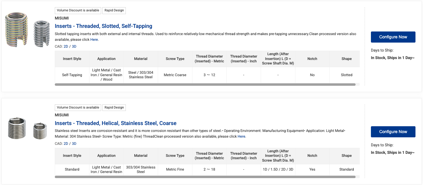

3. Use Threaded Inserts
Threaded inserts, such as helicoils or key inserts, are usually advertised as being used for repairing faulty threads. However, installing them into a soft metal part will give your screws a harder surface to thread into. If you plan to be taking your assembly apart multiple times, this can preemptively prevent threads from getting worn down or stripped.
Threaded inserts, such as key inserts (pictured above) can be beneficial for soft metal parts; source: Newman Tools
Threaded inserts such as key inserts pictured above can be beneficial for soft metal parts source Newman Tools

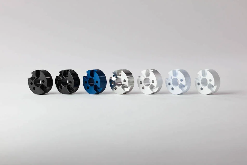

Finally, to really make your pieces feel like finished parts, you may want to add some type of surface finishing. The most common finishing process is anodizing aluminum for extra hardness or to add color.
Surface finishing such as media blasting with anodizing on your metal parts is beneficial for functional and aesthetic purposes.‍
Media blasting and anodizing aluminum can give it a very professional, finished look (for reference, MacBook bodies are media blasted and anodized).
Whether your surface finishing is for functional or aesthetic reasons, there are several options that can be configured for in the Fictiv platform. You can see the full range of finishing options here. For complex designs, multiple finishes may even be combined.

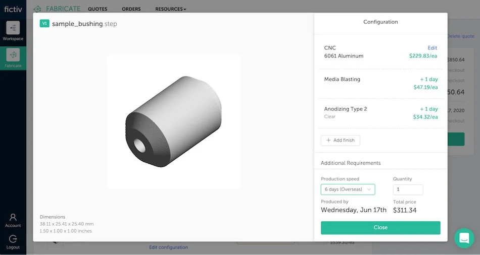

Once all your designs and drawings are nailed down, it’s time to order them. On the Fictiv platform, uploading a drawing with your requirements called out is easy, and surface finishes can be configured for each part directly.
You can quickly configure parts with multiple finishes on the Fictiv platform and upload a 2D drawing that calls out your tolerance and hardware installation requirements.
Finishes will only be added in an order and combination that is manufacturable, and any concerns about hardware or masking will be flagged in the manufacturability feedback in your quote before checkout. Then, your parts show up ready to use, so you can quickly get to what you do best.
