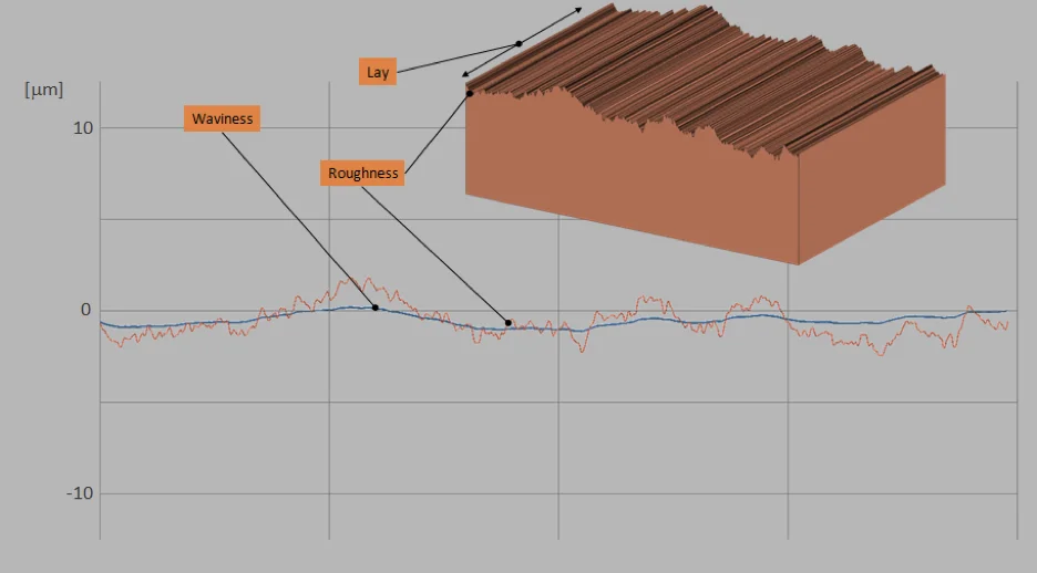

The Three Surface Finish Characteristics
  1. Lay: Direction of the predominant surface pattern. Some examples: radial, vertical, horizontal, cross-hatched, circular and isotropic.
  2. Roughness: Measure of the total spaced surface irregularities. These deviations can be plotted as a profile (see illustration below). There are different methods to quantify roughness, but the most popular defines averages like arithmetic mean deviation Ra, Root mean squared Rms, and others. Always check what method and parameters are being used in your project – they’ll affect product specifications and result in different values.
  3. Waviness: Similar to roughness, these are surface irregularities but with greater spacing.
an image with a 3D model of a block with a rough surface, showing different surface finish characteristics

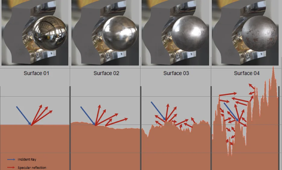

Pay Attention to Surface Roughness
You can see a visual comparison of surfaces with different roughness values in the image below. In addition to changing the look, roughness plays a key role in contact mechanics since higher roughness values increase friction and cause faster wear on components. More roughness also means more surface irregularities that can become nucleation sites for corrosion and cracks. Still, higher values of roughness aren’t necessarily bad; when you’re interested in adhesion, roughness can be a benefit if you choose an appropriate material and surface finishing option.

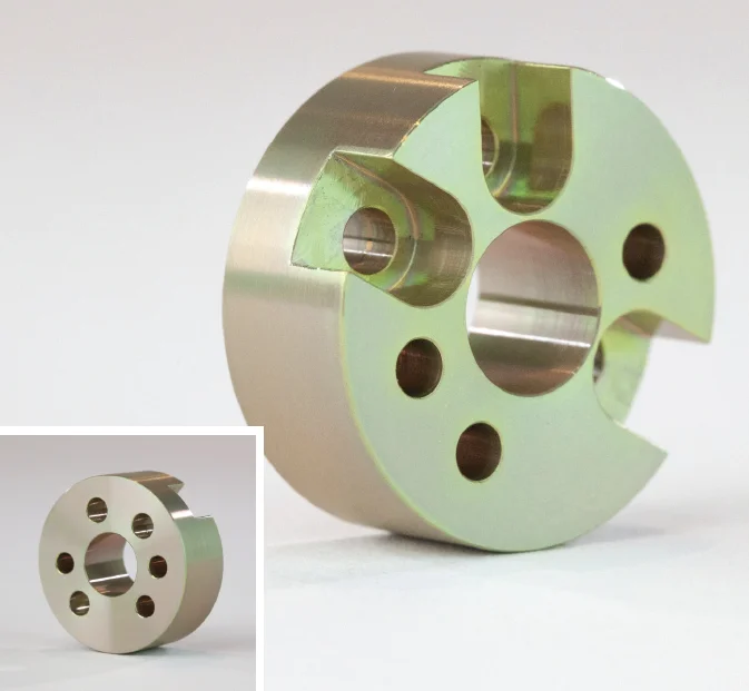

A circular metal part with holes drilled in it, finished using Alodine
Gold Alodine
Alodine
Alodine, the brand name of chromate conversion coating, is also known as chem film. It’s a thin coating used to passivate aluminum. The bath of chemicals used to apply the coating is often made with proprietary formulas, but all use Chromium as the main component. When requesting Alodine for your machined parts, you might see the process is to MIL-DTL-5541F spec, which refers to the US Military Specification of Chemical Conversion Coatings on Aluminum and Aluminum Alloys.
Alodine’s protective layer serves as a corrosion inhibitor and improves adherence for paints and adhesives, so it can be used in conjunction with decorative finishes. Alodine also allows aluminum to maintain its thermal and electrical conductivity, while other finishes mitigate that conductivity. The color can be clear, gold, yellow, or tan, depending on the exact product used. It’s typically a cheaper process, and the coating is prone to scratches and superficial damage.

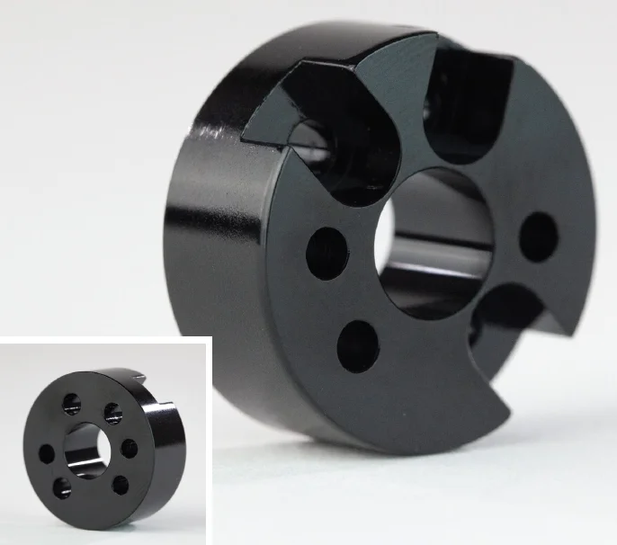

A circular metal part with holes drilled in it, finished using black oxide
Black oxide
Black Oxide
Black oxide is used on ferrous materials such as steel and stainless steel and it creates a layer called magnetite (Fe3O4) that provides mild corrosion resistance. It’s applied using a high-temperature chemical bath that contains alkaline cleaner, water, caustic soda, and a sealant such as oil to provide a smooth, matte finish. There are also variations of this process that function at cooler temperatures, but they offer less abrasion resistance. Masking is not necessary with black oxide as its application does not significantly affect the dimensions of the part.

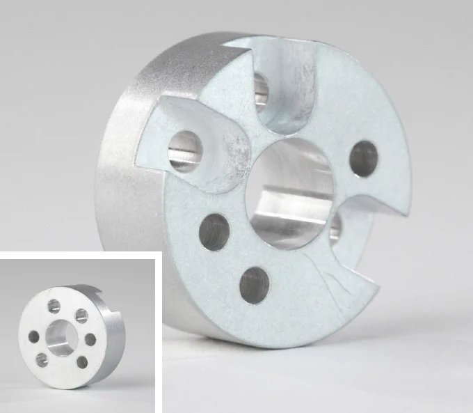

Media blasting creates a matte surface finish
Media Blasting
Media blasting is an abrasive finishing process that removes debris and changes the surface roughness of parts. It works using a pressurized jet to fire an abrasive, usually glass or plastic beads or sand, toward the surface of a part. The effect is similar to using sandpaper, but it’s a faster process that provides a more even matte finish. It also works well finishing corners and fillets. A variation of this process uses water to lubricate the surface and trap dust, but bear in mind that using wet blasting on mild steel will result in immediate corrosion.

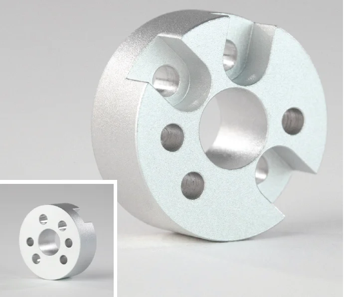

Media blasting can be used on most metals, including brass, bronze, and copper, and is often combined with other finishes, like anodizing, for its aesthetic benefits.

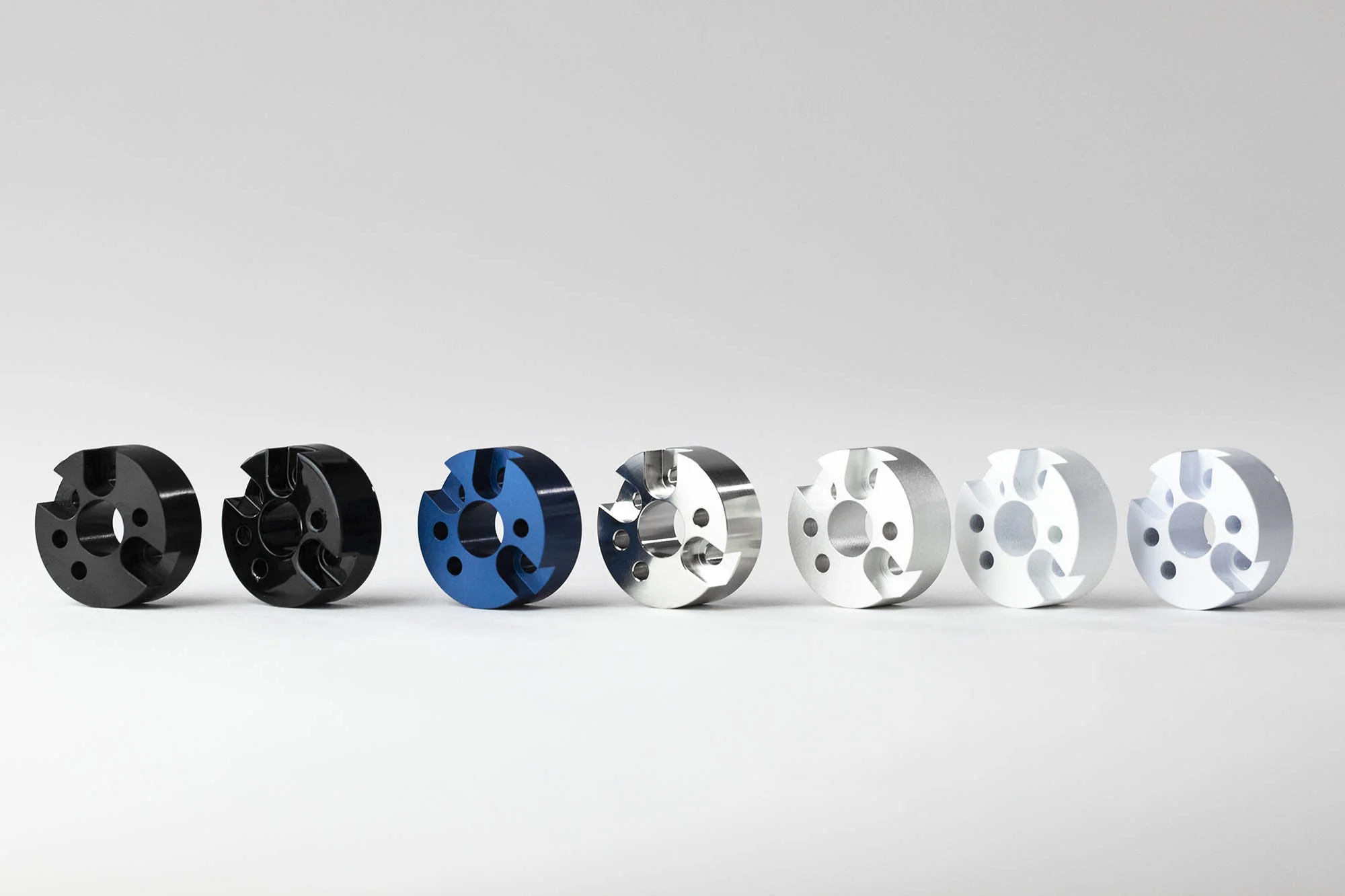

Combining Multiple Finishes

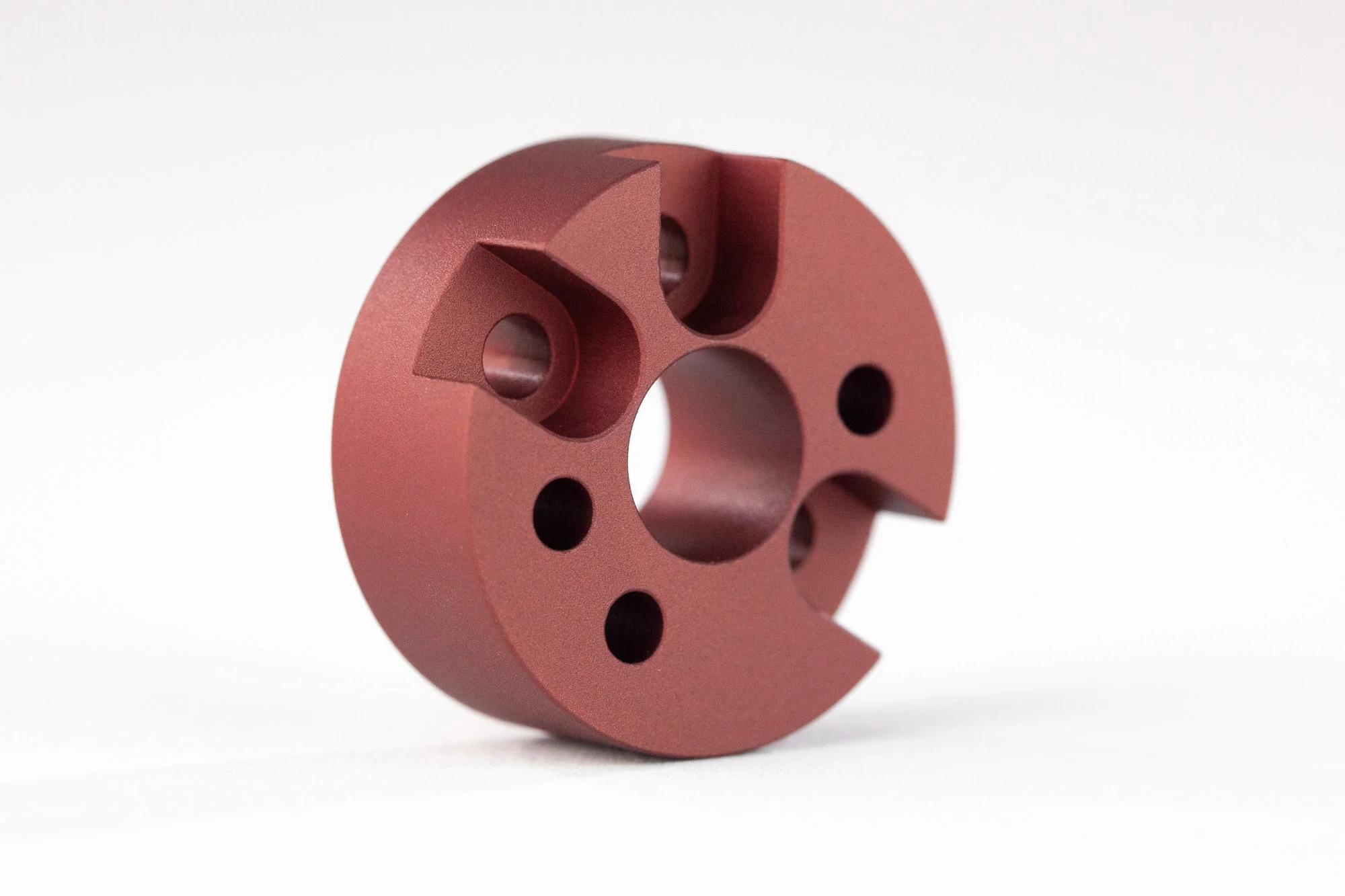

Multiple finishes can sometimes be combined to take advantage of their different properties. For example, media blasting is often done before applying other finishes to hide machining marks and give parts a smooth, matte finish. By combining media blasting with anodizing, for example, you’ll get the surface finish found on Apple’s MacBook laptops.
a metal part finished with media blasting and red anodizing
Combining media blasting and anodizing gives a smooth, matte, colorful look to your parts.
Type II anodizing and Alodine can also be combined, though that combo requires masking areas you need to retain thermal and electrical conductivity. And passivation and black oxide are often applied in tandem to steel to provide both corrosion resistance and a nice cosmetic finish.
