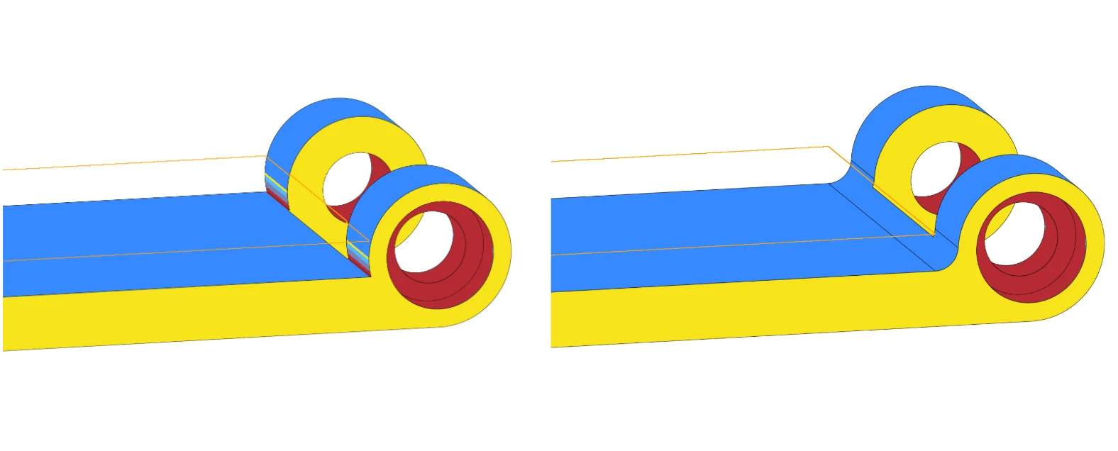

Sheet Metal Fabrication
Sheet metal design guidelines suggest using the right bend radii when bending sheet metal to prevent cracks due to bending too sharply. The presence of relief cuts can also help prevent deformation and tearing, ensuring better forming accuracy. Features like tabs and slots help parts fit together easily, making assembly quicker and more accurate. These design details make the fabrication process more efficient and reliable

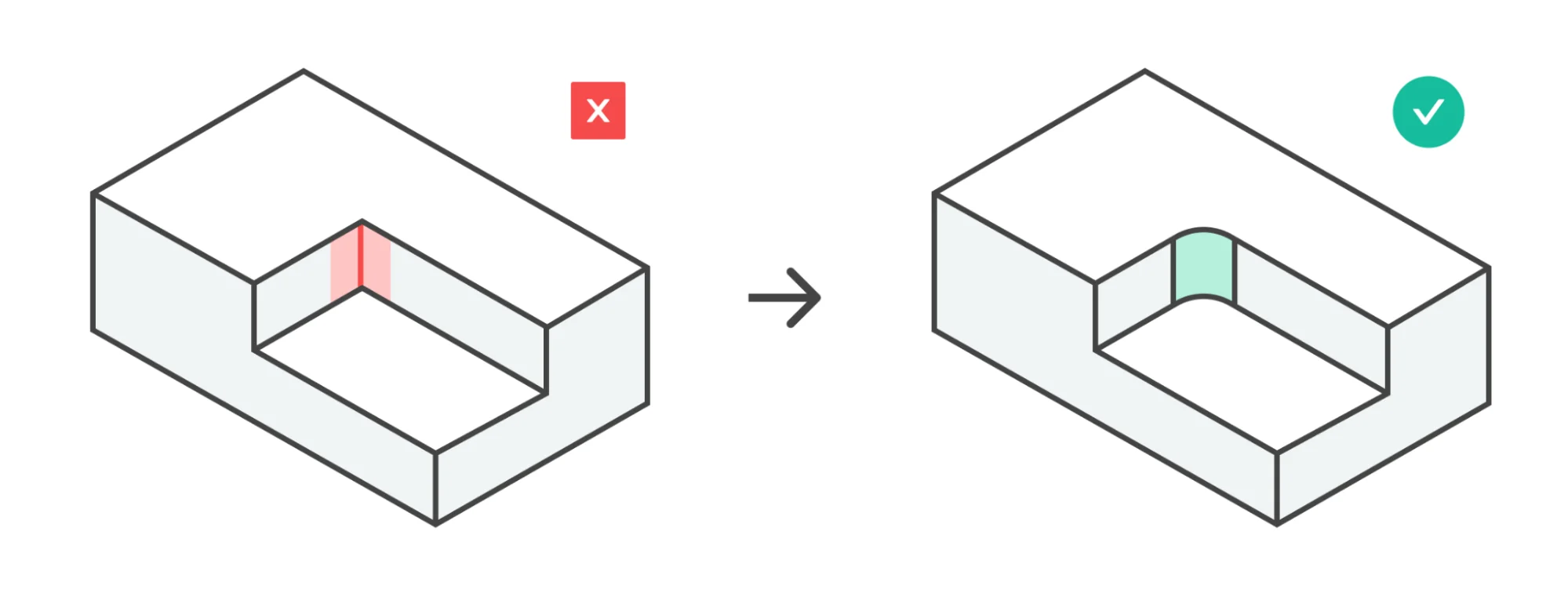

Sharp Internal Corners
Another frequent issue is sharp internal corners in a design. Most machining tools have a finite radius, so perfectly sharp inside edges cannot be produced without additional operations such as EDM. Sharp corners also create high stress concentrations, increasing the risk of cracks and fatigue failure. Adding internal fillets or radii reduces stress, improves durability, and simplifies manufacturing for multiple processes.

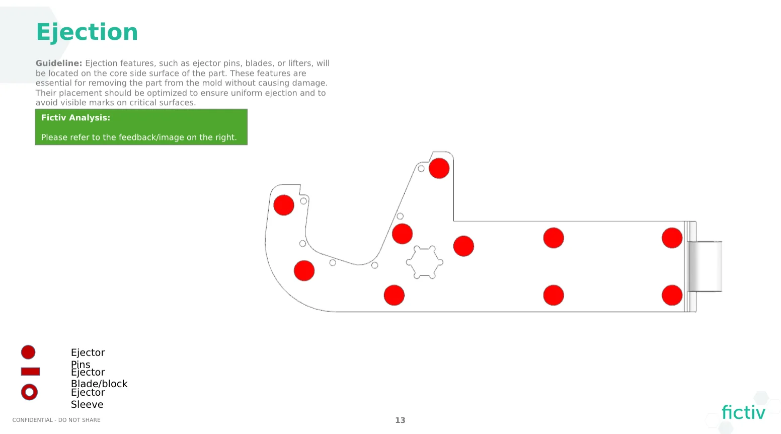

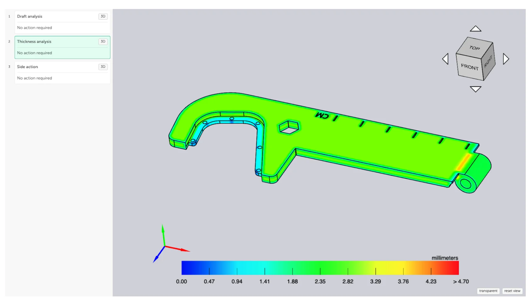

Instant Quoting With DFM Analysis
Digital manufacturing platforms such as Fictiv offer powerful DFM tools for teams needing immediate manufacturability feedback. With Fictiv’s digital manufacturing platform, you can upload a CAD file and receive an interactive quote that highlights potential DFM issues. The platform analyzes factors such as wall thickness, draft angles, tolerances, and material suitability for a variety of processes, such as CNC machining, injection molding, and 3D printing. This early insight enables design teams to refine their models before production begins. The combination of automated DFM analysis and expert engineering feedback helps accelerate product development while reducing the risk of late-stage surprises.
