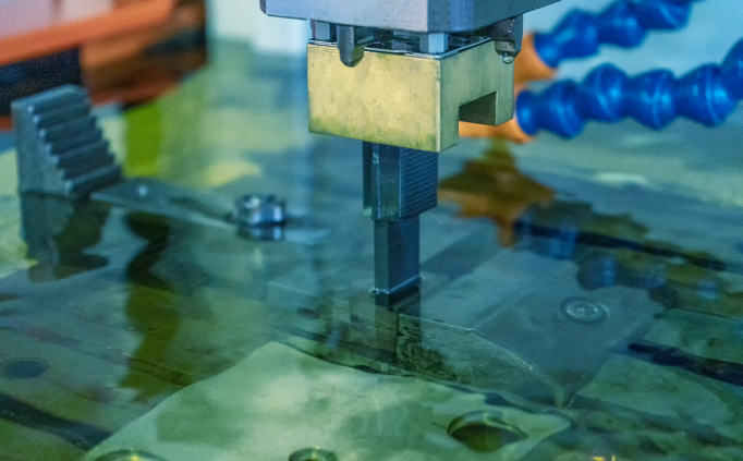

About Electrical Discharge Machining
Fictiv offers two types of Electrical Discharge Machining (EDM) processes, which are useful for cutting deep pockets and complex features such as gears and holes with a keyway. EDM is also a non-contact machining method and does not exert cutting forces on the part, therefore it works particularly well for delicate structures.
Wire EDM Services
Wire EDM is performed by submerging a metal part in dielectric fluid where an electrically charged wire is then fed through the submerged metal component. The current passing through the wire creates sparks which cut through the material and form the desired shape of the component. Wire EDM is an ideal manufacturing process when you have clearance for the wire above and below the part feature.
Sinker EDM Services
‍The first step to performing Sinker EDM is to machine an electrode into the shape of the cutout you want to make. Sinker EDM is then performed by plunging your charged electrode into the metal component, which is submerged in dielectric fluid. The current passing through the electrode creates sparks which cut away the metal and form the desired shape of the internal feature.
Sinker EDM can be used to make bevel gears, internal gears, spiral gears, worm gears, however the process is very slow and costly so this may not be the best method for all applications. Sinker EDM can be used to create hard-to-reach, angular internal features such as blind keyholes which cannot be machined using other methods.
