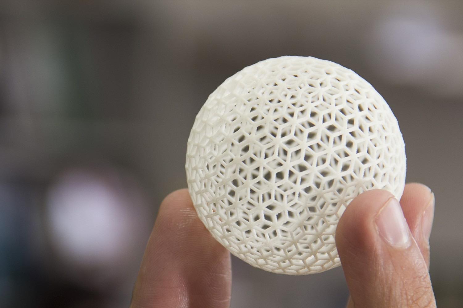

3D Printing Elastomer Prototypes
Finally, 3D printing elastomer prototypes—what you’ve all been waiting for—or rather, what we’ve all been waiting for. This technology is still new (even by 3D printing standards) and imperfect, but nevertheless, it’s amazing. It isn’t perfect for all applications, though, so let me guide you through your decision for your design.
The older method of simulating rubber used selective laser sintering (SLS) with a flexible base, which resulted in an elastic part. However, the parts are still quite stiff, have low stretch, break after repeated flexure, and have a low resolution finish—not ideal for many prototypes. Until recently, this was the best that could be hoped for, but newer materials are making their way into the market.

‍<em>SLS can create complex shapes but with a rough surface<em>
