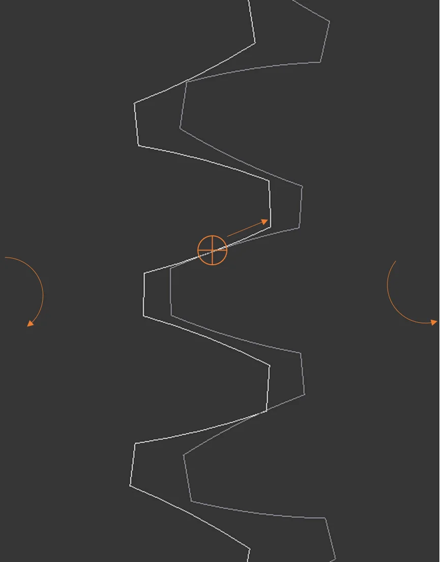

The teeth profiles follow a geometry that consists of an involute of a circle — basically, a spiraling curve traced by the end of an imaginary string unwinding itself from that stationary circle — or if you trace the point of contact from one tooth to another as shown in the following image.
involute curve shape on a gear
Involute curve geometry
The Sunderland Method is excellent at creating teeth of uniform shape, and all gears that are cut by the same cutter will, in theory, gear correctly with one another. So, gear designs that require high precision — even double helix gears — can be fabricated with this method. The Sunderland Method is also versatile and cost-effective, especially for medium to high-volume production runs. And because the Sunderland system has been actively maintained since its invention, manuals and documentation are widely available and relevant even for new machine designs.

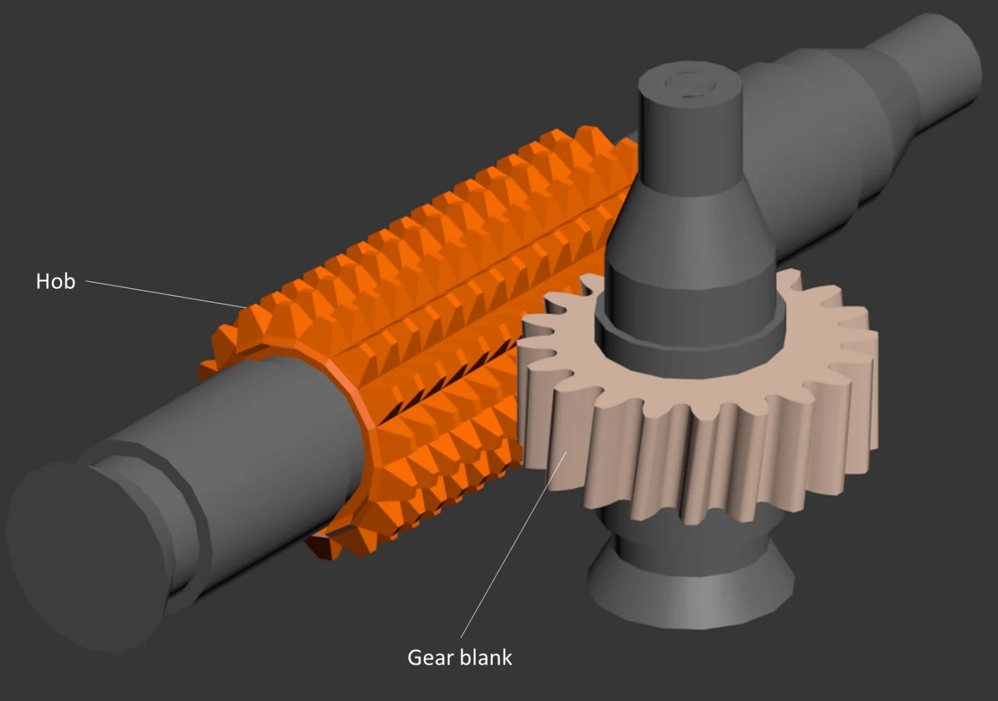

Gear Hobbing
Gear hobbing produces gear teeth by rotating a cylindrically shaped cutter called a “hob” (hence the term gear hobbing) depicted in the gear hobbing machine interface below. The hob can be single-threaded, depending on how many teeth per revolution should be generated.
graphic representation of gear hobbing process
Gear generation Hobbing
Spur gears are most often fabricated with this method, although a variety of other gears — like cycloid gears, helical gears, worm gears, ratchets and sprockets — are all made by hobbing. A well-designed hob is critical, especially when cutting a complex geometry, and this process typically does not work for internal gears. Similar to gear shaping, hobbing has setup advantages, but only for exterior cuts since the hob is cutting the outside of the gear blanks.

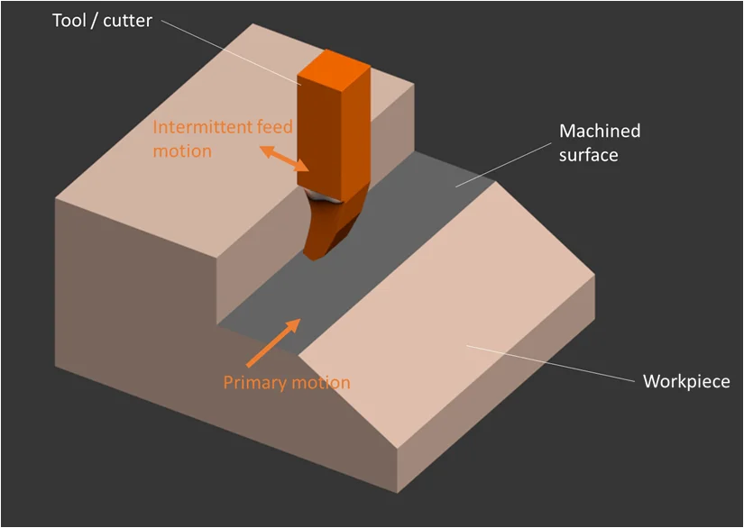

When slotting, the workpiece is held stationary and the tool on the ram is moved up and down across the workpiece.
This diagram shows how a gear slot is cut
Gear form cutting Slotting stationary workpeice and toolcutter Primary Motion is up and down
Both shaper and planer gear machining tools cut in straight lines. However, the shaper handles small-size geometries, while the planer is built for larger applications. Shapers can be used to create slots, grooves, and keyways. Slotting is essentially a vertical shaper that cuts internal gears and grooves.

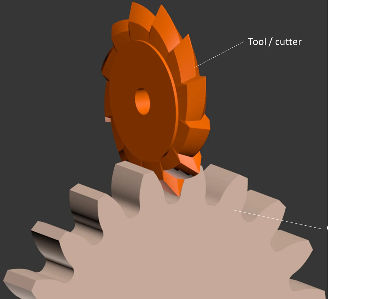

Milling
The milling form cutting method is relatively limited in its use but is well-suited to create complex gear geometries. CNC milling is utilized to machine helical and spur gear wheels for various industries, including automobile transmissions, and hob cutters.
gear milling graphic
Gear form cutting Milling
Milling gears is slow because it creates extensive heat transfer to the workpiece, which means that successive teeth should not be milled one right after the other.

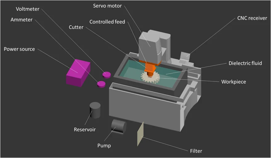

Electrical discharge Machining (EDM)
EDM is an electromechanical manufacturing process where material is removed from a workpiece by applying a series of current discharges between two electrodes separated by a dielectric bath liquid. Rather than cutting, the spark acts as a ‘cutting tool’ that actually erodes the material instead.
EDM is good at cutting complex geometries of all sizes, even as a gear cutting process, but the process has its limitations. If you don’t have good control and precise programming, it’s easy to damage part surfaces — especially curved teeth profiles that are challenging for CNC programs to execute. But high-quality and intuitive 3D modeling and CAM software — like Feature CAM, Autodesk Fusion, Master CAM, and others — can produce the smooth motion needed to cut curved teeth.
graphic showing an eletrical discharge machine making a gear
Electrical discharge machining EDM
EDM machines have improved in recent years, which has minimized issues with surface finishes, and improved cutting precision and resulting material properties (microstructure, mechanical properties, etc). The process can achieve tight tolerances as small as thousandths of an inch and create both small (diameter of fractions of an inch) and large gears (diameter of over 20 inches). This process is used for both delicate applications in watches and clocks and to cut more robust gears like those used in race cars.

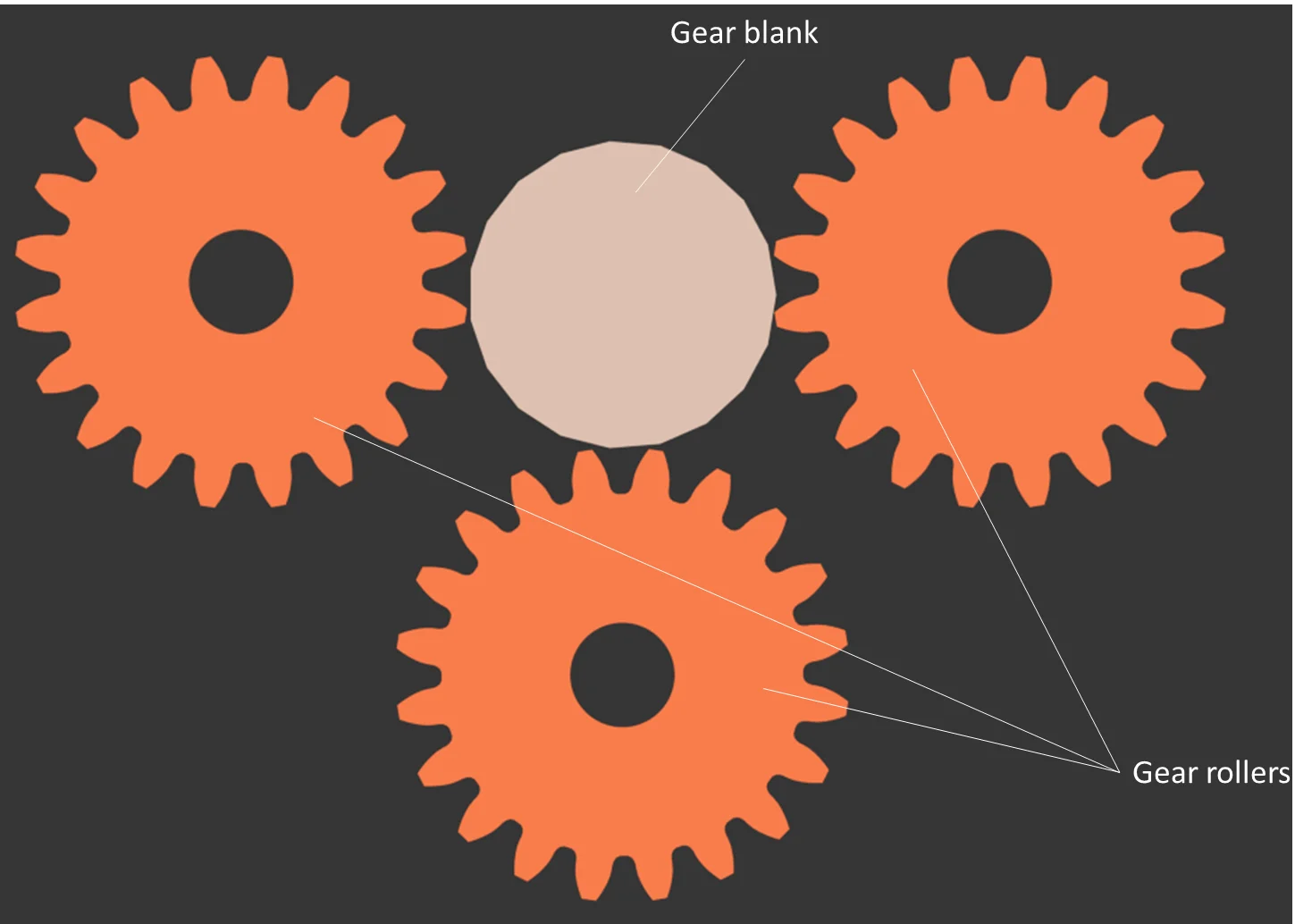

Rolling
Rolling is one of the oldest gear forming processes that hot or cold rolls a blank workpiece through two or three dies, as seen below.
gear forming: rolling
Gear forming Rolling
When material saving is a critical concern during manufacturing, rolling is a good option since there’s no chip generation. However, to get an efficient process, you must consider rolling parameters, deformations, and microstructure effects before ramping up production.

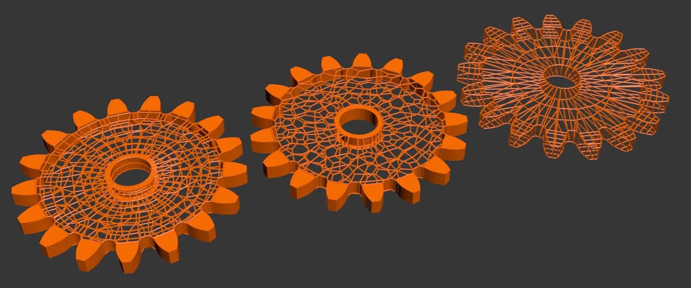

Additive Manufacturing
Also known as 3D printing, additive manufacturing constructs a three-dimensional object, layer by layer, from a CAD 3D model. Due to the nature of the process, additive machines can form complex designs with lattice structures modeled to achieve mass reduction not easily obtained through conventional methods. This type of geometry is often created using 3D topology optimization and generative computer design.
gear geometry made using additive manufacturing aka 3D printing
Gear geometry made using 3D printing
Conventional and non-circular gears can be fabricated with additive manufacturing processes, and high-quality 3D printers are relatively affordable and widely available. Because of this availability, it’s become the choice for repairs and mechanical projects like educational toys or other gadgets needing fully functional gears. You can also include additional features and even combine geometry with the gear shapes to add customized shafts, keys, or grooves to the same solid.
