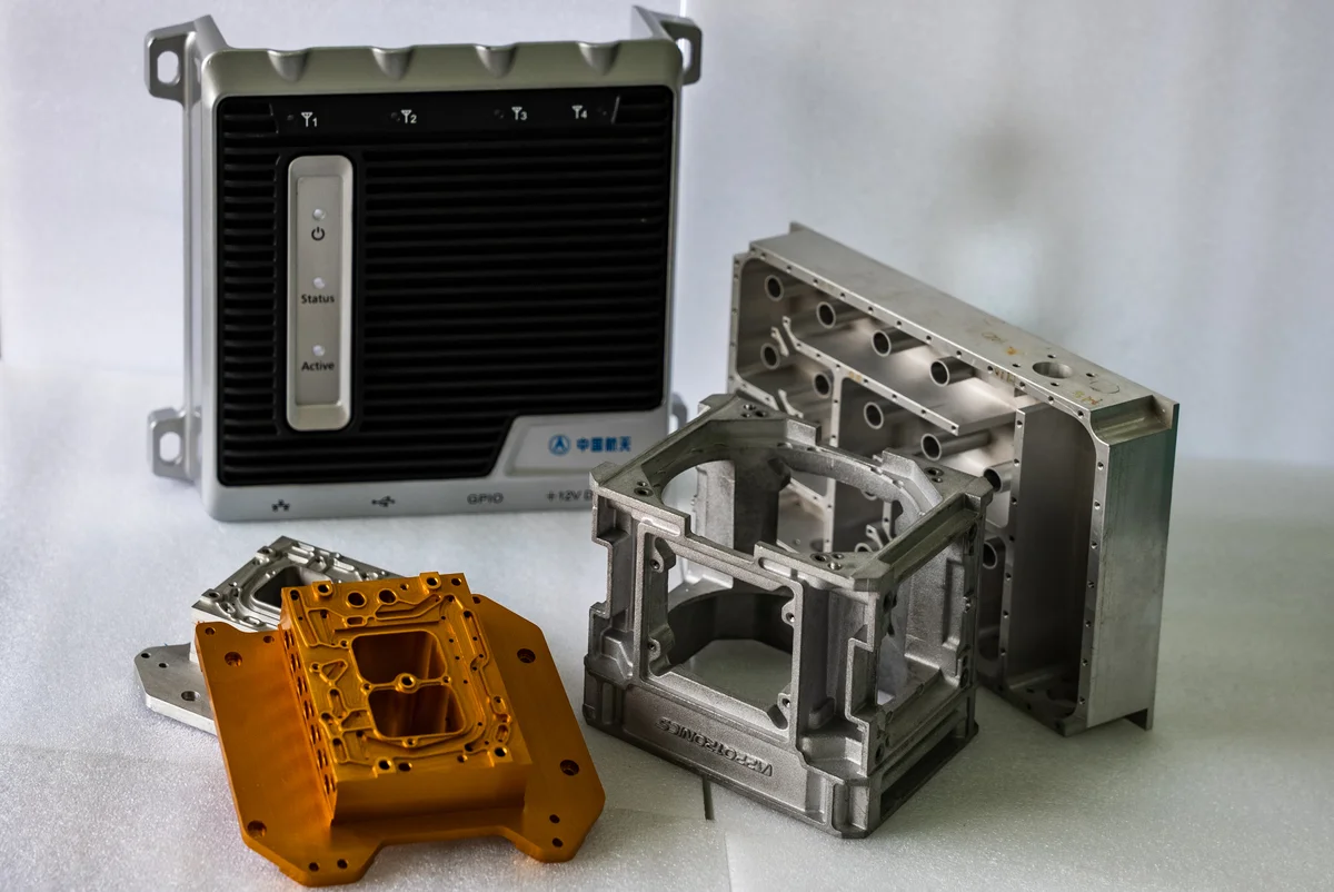

Cast metal prototypes

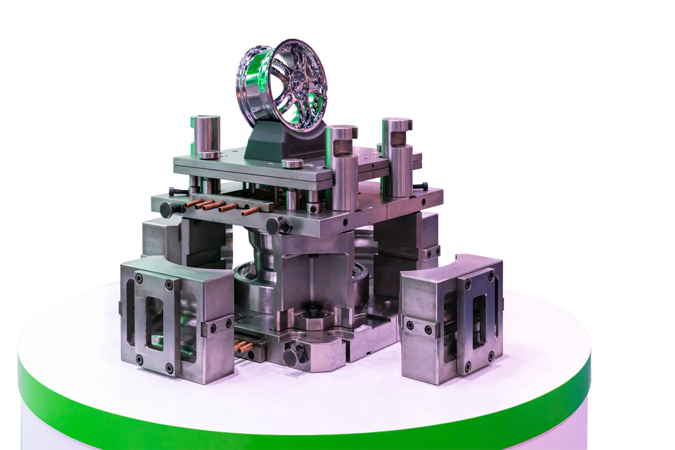

Die casting mold tool used for low volume production
Die casting mold
Die Casting: Production-Like Parts Require a Tooling Investment
Die casting injects molten metal under high pressure into a reusable steel mold. For production programs that will run high-pressure die casting (HPDC), it is the only process that can deliver the same alloy family, fill dynamics, solidification history, and residual stress state, provided the process parameters stay comparable.
Common HPDC materials include aluminum alloys such as A380, A383, A360, and ADC12 as well as zinc. These alloys generally cannot be heat treated to T6 because the high-pressure mold fill can trap gas in the molten metal, causing surface blisters during the solution phase of  T6 heat treatment. If you do not yet need that production microstructure, or the design is still changing, investment casting or gravity casting will usually cost less and move faster.

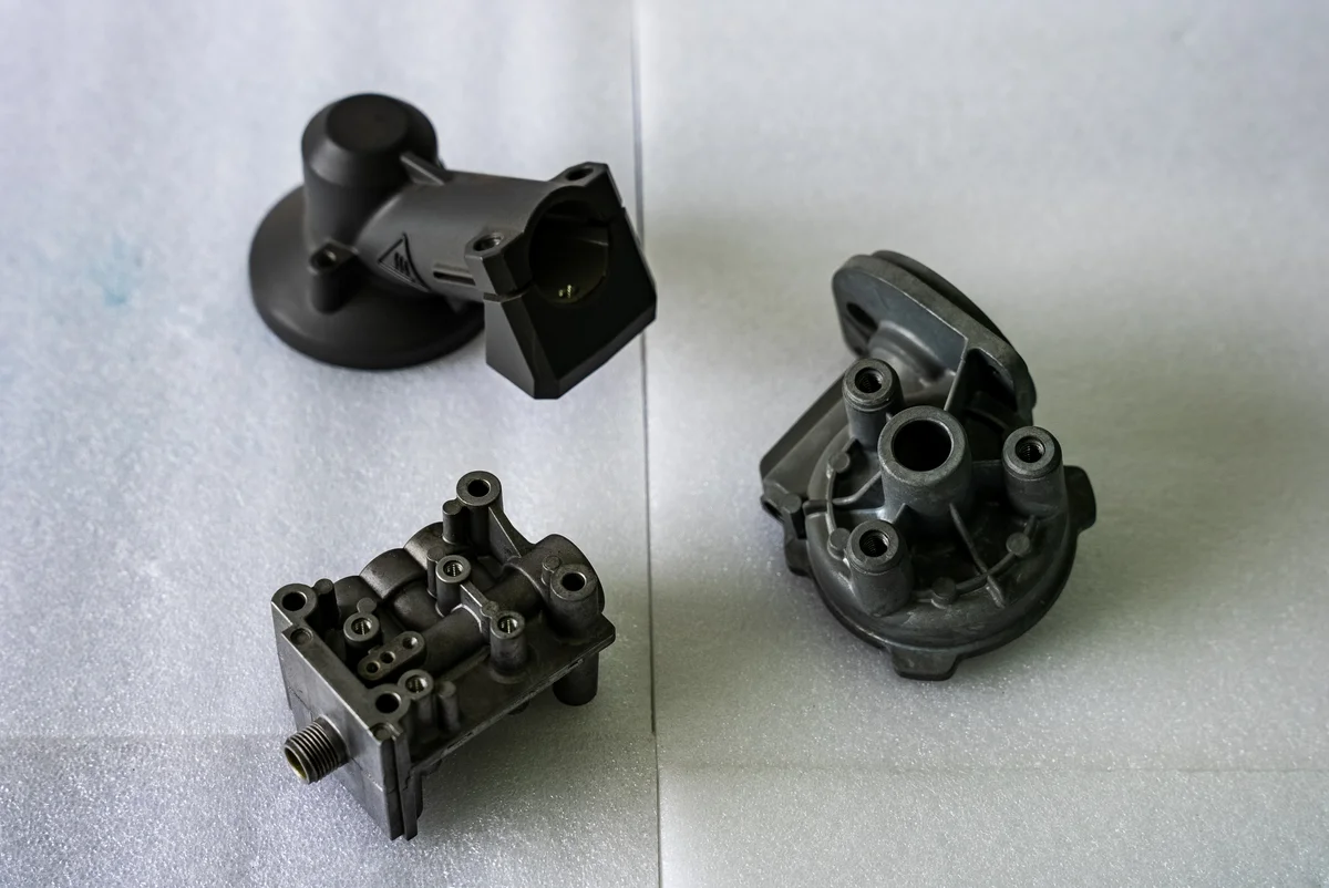

Wax patterns prepared for investment (lost wax) casting
Wax patterns prepared for investment casting
Investment Casting: Complex Geometry at Low Volume
Investment casting (lost wax casting) uses a ceramic shell built around a wax pattern. The wax is burned out, and molten metal is poured into the shell. For prototypes, the wax patterns can be 3D printed, eliminating the need for hard tooling. First parts typically arrive in 1 to 3 weeks, making investment casting one of the most practical metal casting routes for low-volume work.
Investment casting accommodates a broad alloy range: stainless, tool steels, aluminum, titanium, Inconel, cobalt chrome, and many specialty alloys. The surface finish of investment-cast parts is usually Ra 1.6 to 3.2 μm as-cast, with dimensional accuracy around ±0.1 to 0.25 mm on most features. Undercuts, internal passages, and thin walls are routine.
One practical caveat: thin sections cool faster than thick ones in the same part, so local microstructure and mechanical properties can vary with section thickness. Test results from one section may therefore not represent another.
Investment casting is best suited for small- to medium-complexity parts (aerospace and medical components) and projects with too low a volume to justify die casting (1 to 500 pieces). Cycle times are slower for investment casting than for die casting, cost per part rises at higher volumes, and critical interfaces still need CNC finishing. Investment-cast aluminum behaves differently from die-cast aluminum and is not a valid stand-in when HPDC is the intended production process.

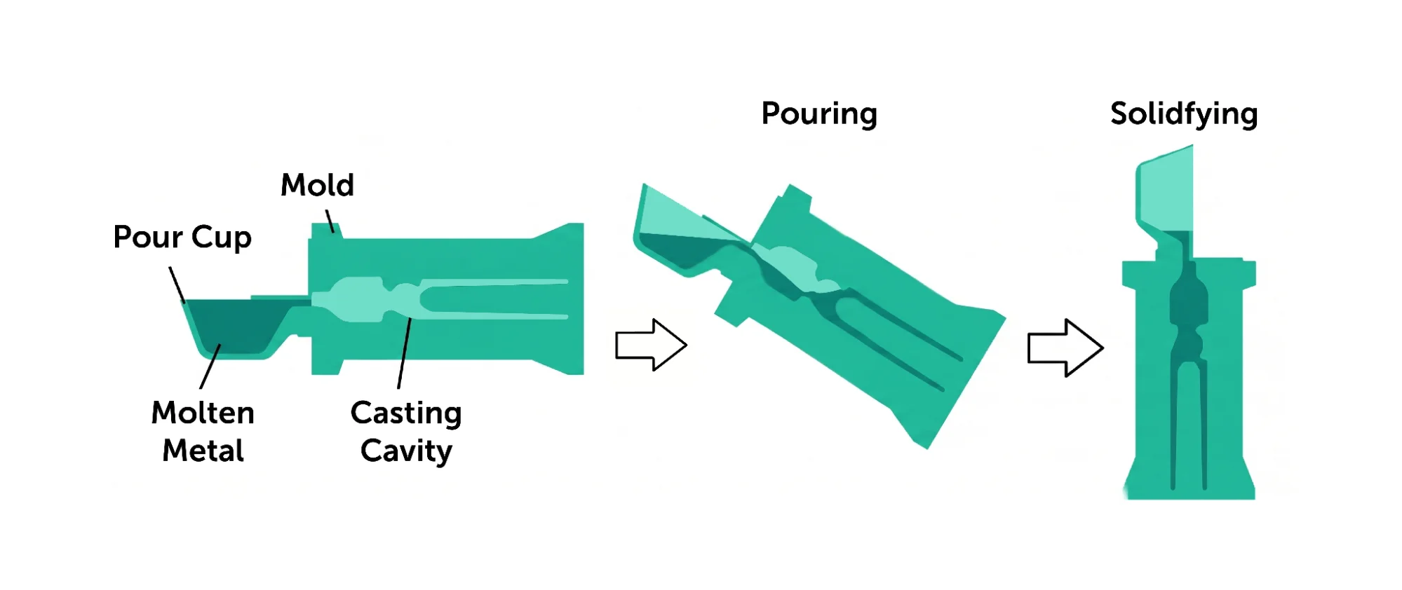

Tilt pour gravity casting diagram
Gravity/Permanent Mold Casting: Structural Aluminum at Mid-Volumes
Gravity casting (permanent mold casting) pours molten metal into a reusable steel or iron mold under gravity rather than pressure. It sits between die casting and sand casting in terms of cast part quality: better surface finish and dimensional consistency than sand casting, lower tooling cost, and lower porosity than HPDC. It is a common route for the production of heat-treatable aluminum castings at moderate volumes.
Using only the force (pressure) of gravity to fill a mold produces less turbulence and less trapped gas in the resulting casting than high-pressure injection. That lower porosity lets alloys such as A356 reach T6 without blistering. Tooling for gravity mold casting is simpler than that for HPDC, and is typically less expensive. Tooling lead time is in the 3 to 5 week range: less than for HPDC, but longer than it takes to get started with investment casting. Surface finish of gravity mold castings is typically Ra 2 to 6 μm, and tolerances land around ±0.2 to 0.5 mm depending on part complexity.
Permanent mold casting prototypes are best for mid-complexity aluminum housings, structural parts, pressure-tight enclosures, and any project where porosity or heat treatability matters. Compared to HPDC, gravity fill castings are restricted to higher minimum wall thickness (around 3 to 4 mm for reliable fill and feeding), more limited undercut geometry options, and slower production cycle time.

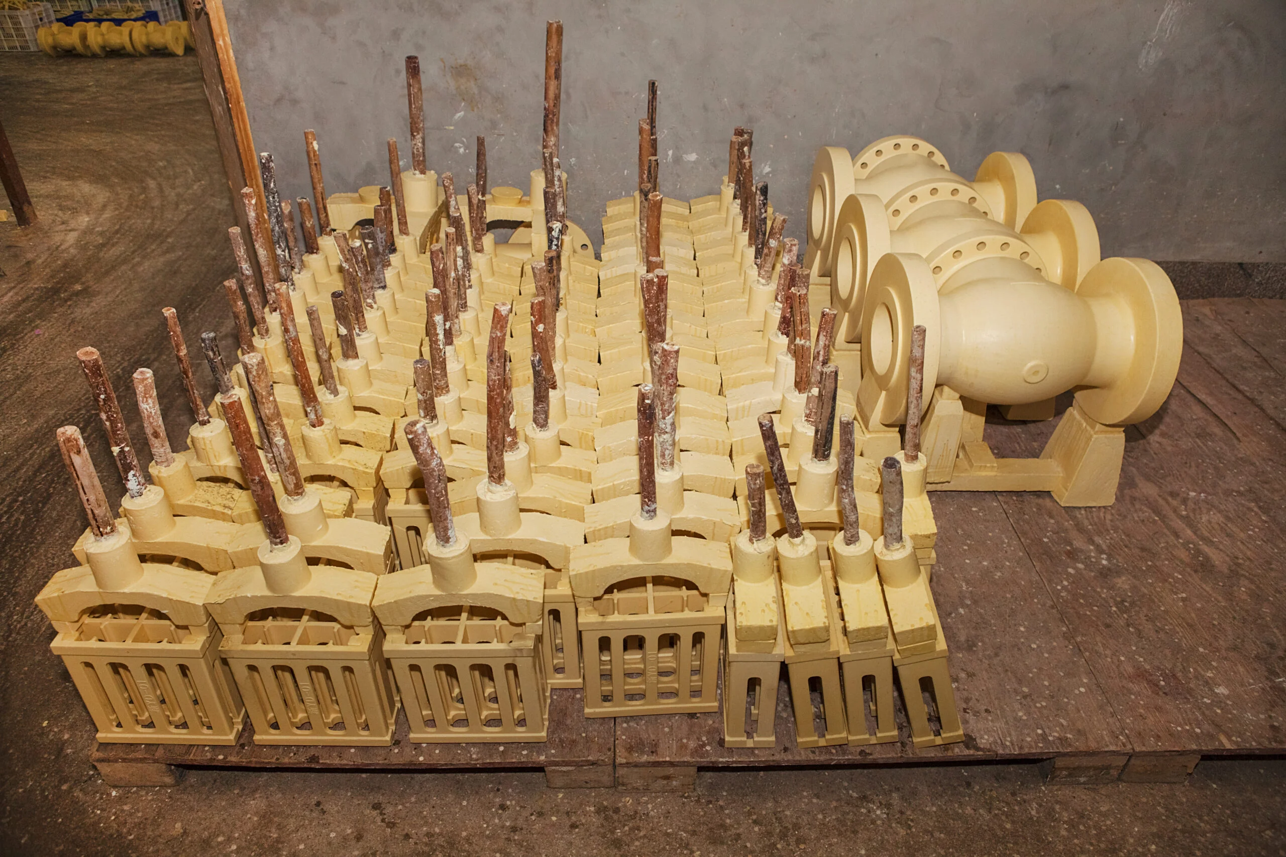

Sand casting has the lowest tooling cost and the most flexibility for large parts or single-piece quantities, but surface finish and dimensional accuracy lag the three primary methods.

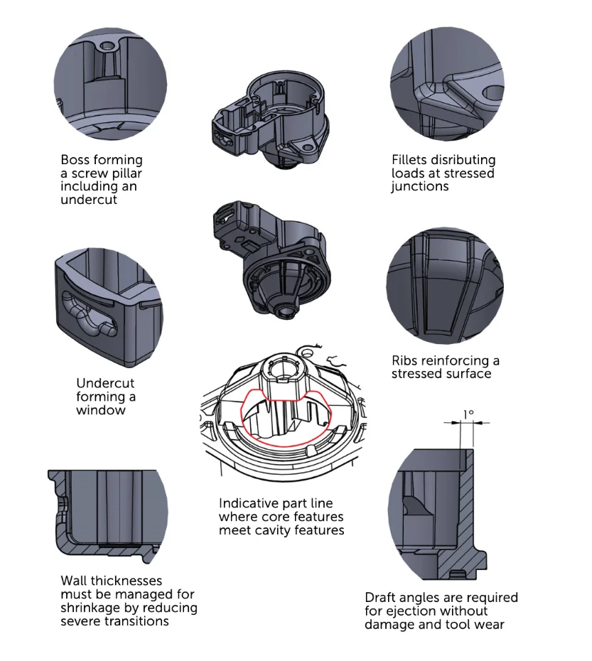

Die casting DFM guidance
Wall Thickness
Minimum wall thickness depends on the casting process. High-pressure die casting (HPDC) can typically achieve aluminum alloy wall sections of 1.5 to 2 mm. Investment casting generally supports 1 to 2 mm, depending on the alloy and geometry. Gravity casting usually requires 3 to 4 mm minimum to ensure reliable mold filling and feeding.
Design to the wall thickness your strength requirements demand, then choose a casting process that can reliably produce it. Unnecessary thickness creates hot spots that cool more slowly, increasing the risk of shrinkage porosity while also extending cycle times and raising material costs. When additional stiffness is required, use ribs or gussets instead of thickening the entire wall.
Draft Angles
Every casting process benefits from proper mold draft angles to facilitate part or pattern removal.
Die casting typically requires 1° to 3° of draft, while gravity casting generally needs 2° to 5°. Investment casting is more forgiving because the ceramic shell is destroyed after solidification, but incorporating modest draft still improves dimensional consistency and helps reduce residual stress caused by mold constraint.
Post-Casting Machining Allowances
Almost every cast prototype requires CNC machining on critical features such as sealing surfaces, precision bores, bearing seats, and mating interfaces. Cast in 0.5-1.5 mm of machining stock on these surfaces and clearly identify the allowance on the engineering drawing.
Parting Lines, Gates, and Shrinkage
Parting line and gate locations should be reviewed with your manufacturing partner before tooling begins. These decisions influence how molten metal fills the cavity, affect cosmetic appearance, and determine where porosity is most likely to occur.
Design parts to their nominal dimensions and let the foundry apply the appropriate shrinkage compensation during tooling design. Typical linear shrinkage is approximately 0.5 to 0.6% for HPDC, 0.8 to 1.2% for gravity casting, and 1.0 to 1.5% for investment casting, depending on the alloy and section thickness.
Shrinkage is never perfectly uniform. Thick sections cool and contract differently from thin sections, which can introduce distortion across the part. For that reason, critical interfaces should be machined to their final dimensions rather than relying on as-cast tolerances.
