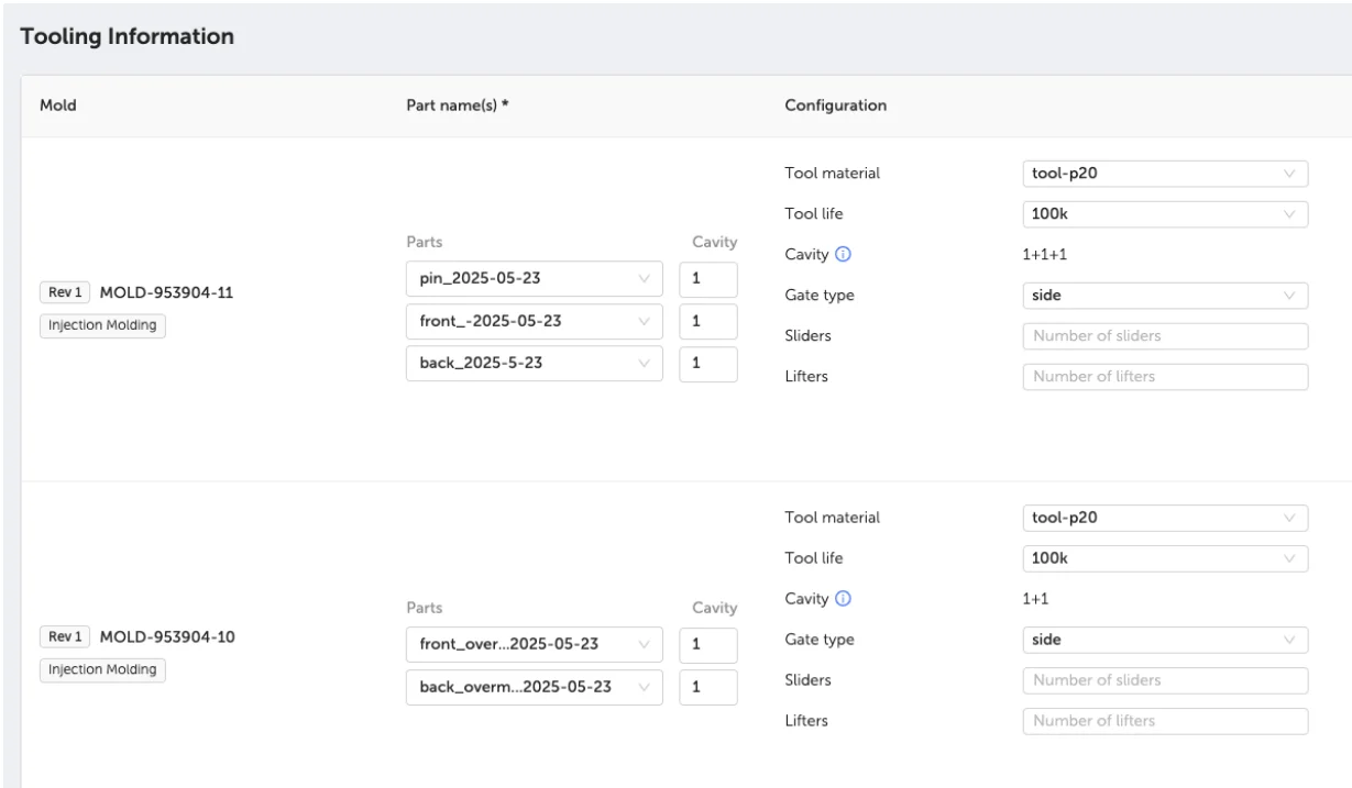

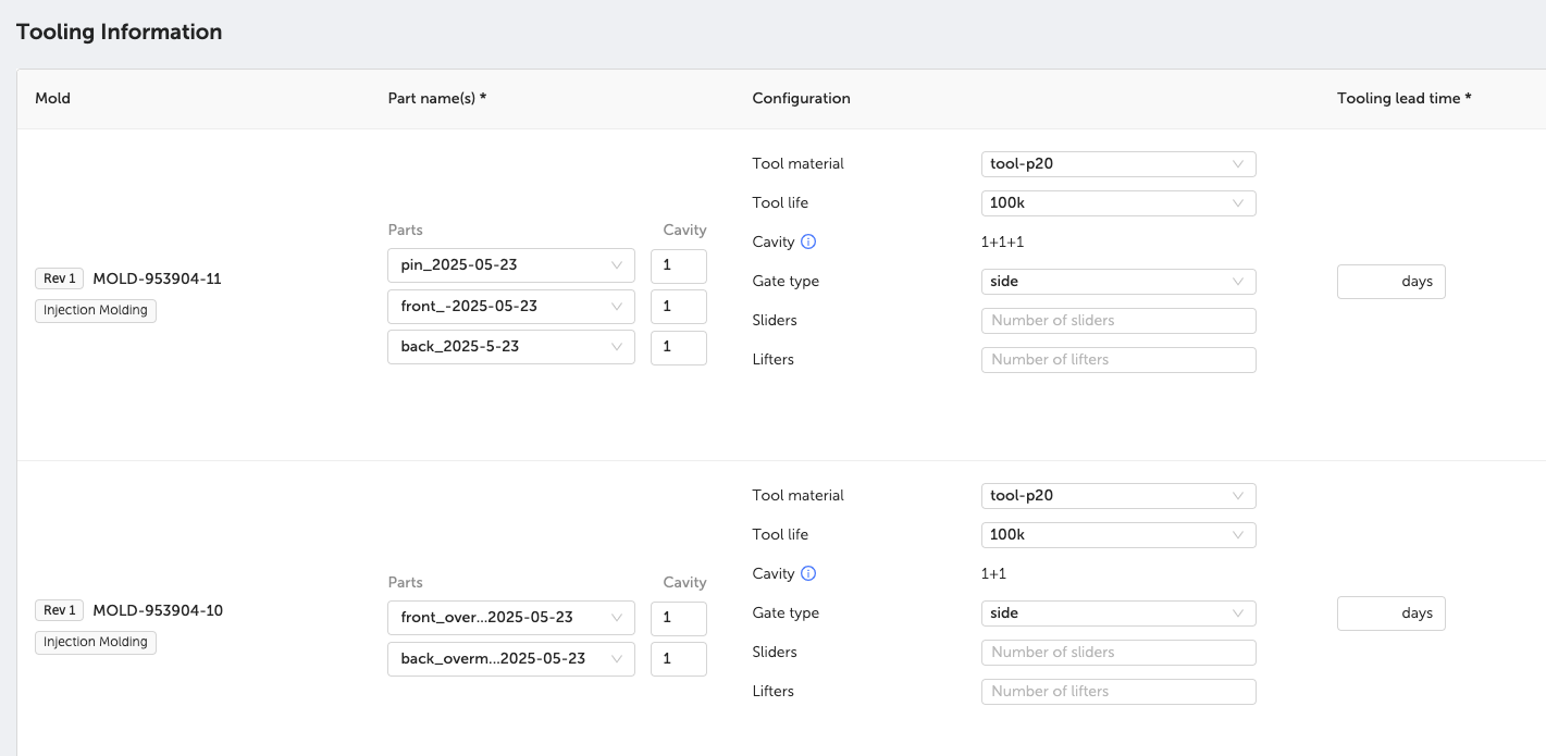

For our phone stand tool, we went with a P20 steel mold base with 100K shot life. The configuration was a 1+1+1 family tool (with 3 unique cavities) for the “front”, “back”, and “pin” parts, as well as a 1+1 tool for the TPU overmold parts.
This was a practical solution because the largest parts molded with PC/ABS were unique yet quite similar. However, after molding these parts, the 3-cavity tool had to be “washed” to remove excess material from gates and runners before injecting with glass-filled nylon for the smaller pin part. Cavities can be plugged, or closed off as necessary.

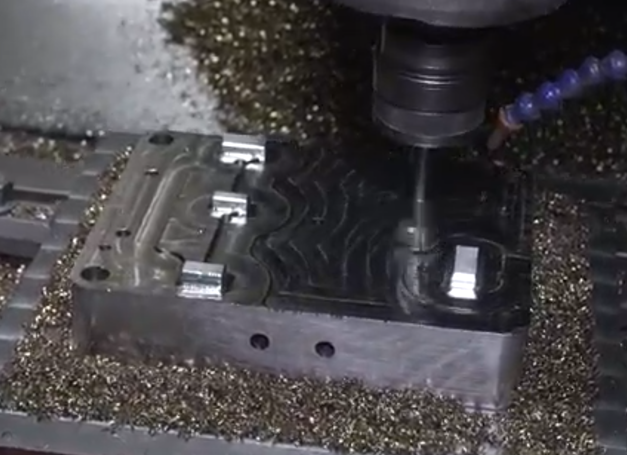

CNC Machining: Cutting the Tool Geometry
Once the steel is prepped, CNC milling is used to cut the majority of the tool’s geometry. High-speed machines carve out complex 3D shapes—bosses, ribs, shutoffs, and functional features—with tight tolerances and clean finishes.
Each half of the mold is machined separately, and alignment is absolutely critical. This is where precision matters: a micron-scale misalignment in the tool can result in flash, mismatch, or parts that simply don’t fit together.
Cosmetic surfaces are milled with careful attention to tool paths and surface finish, especially in areas that will be visible to users.
Rough cut CNC machining of the FictivMade tool

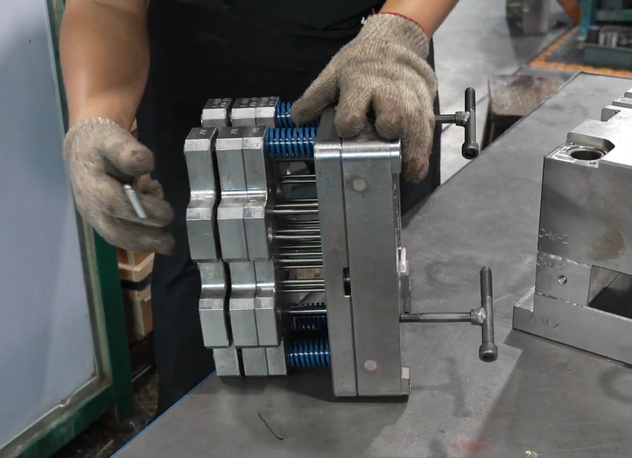

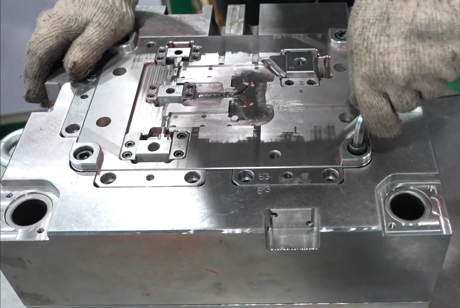

Tool Fitting and Assembly
At this stage, toolmakers shift to benchwork and fitting.
Core and cavity blocks are aligned. Sliders are installed and tested for motion. Ejector pins are checked for clean, even travel. Surfaces are polished, mating areas are deburred, and the tool is prepped for trial.
This is where craftsmanship and engineering come together, as hands-on tuning ensures that what works in CAD also works on the shop floor.
Assembly and fitting of the tool

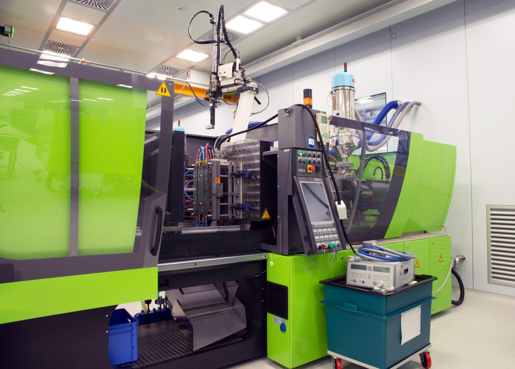

With all components assembled and validated, the mold is installed into an injection molding press for its first shots, known as T0.
This is the real test: molten plastic is injected into the mold for the first time. Engineers evaluate:
- Part fill and flow
- Flash or short shots
- Weld lines and sink
- Ejector pin marks
- Gate vestige and cosmetic quality
The goal of T0 is insight, not perfection. The data and visuals from these early parts will inform changes and refinements in the next step of the FictivMade process: sampling and iteration through T1 and beyond.
