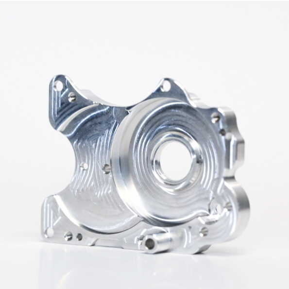

PART STUDY
Milled Plate for HEBI Robotics
Production Location
AS-9100 Certified Overseas Manufacturing Partner
Secondary Processes
Heat Treating, Anodizing Type II, Media Blasting
Quantity of Parts Made
14,500
